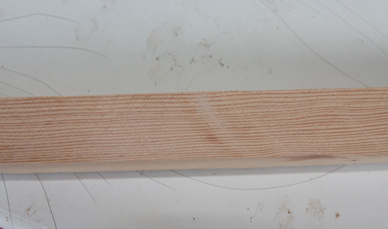

Would a pic of the grain and general color of the wood I have help identify the species or are they too similar ?
I'm putting up a pic just in case / but doubt it can be pinpointed to an exact species from a picture !!

Thats really interesting Arnold !! In my part of the world there is a surplus of old (80yrs plus) Oregon pine (Douglas Fir) - would this suffice as tonewood or would it be ?
I have worked on two basses with Doug Fir tops. Both sounded so-so, and both were riddled with splits.

I have no idea, really. Did I mention Douglas Fir in my post above? I don't think that it grows in New England where most of the basses were made. Actually, it's grows about 3,000 miles west of here, sorry. That doesn't mean it can't be used. I just can't answer you on that though, sorry.

well I guess there goes the Douglas Fir theory - out the window
