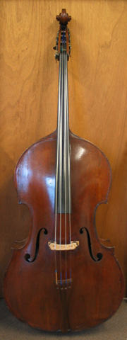

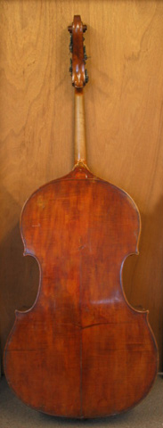

Hello everyone! Folks over at TalkBass directed me to this forum because of this specific thread on Czech shop/factory basses; looks like a fantastic place! I wanted to post some details about my early 20th c. Czech factory bass with two goals in mind:
  1. Provide details for others to compare their instruments and for general research
  2. See if forum members could provide me with additional info about my bass
The bass isn't for sale; I've owned it for nearly 20 years and I will probably keep it forever. It's a fully carved, round back bass with violin corners that underwent a complete restoration in 1998-2000. Here's a decent photo (details below the photo if you are still interested after seeing it):
Probable Origin
  • This bass was imported by Buegeleisen & Jacobson (B&J New York) in the late teens or early twenties of the 20th century. B&J was a music "jobber" with a mail order catalog for all kinds of instruments, including violin family instruments, guitars, banjos, ukes, etc.
  • Salvadore De Durro is a made-up name, not a real maker. It was the import brand of B&J, which sold all kinds of factory violin family instruments and strings under this label.
  • The bass was probably built in the Schönbach/Luby area on the border of modern-day Germany and the Czech Republic.
  • It was originally thought to date from 1911, but this cannot be correct. Because a label inside the bass says "Made in Czechoslovakia," it must post date the end of WWI, making its earliest date of manufacture 1918.
  • The mid-grade quality of the wood and the round back place it in the nicer-than-average category of "shop" or "factory" bass made for the American export market
Current Owner
  • I purchased this instrument during grad school from Elderly Instruments in Lansing, MI in 1992
  • The bass was in playable yet deplorable shape when I bought it; several amateur refinishing/repair attempts had been made. The top was deeply sunken in the upper bout, and the bass bar was broken. Open cracks were filled with globs of boat epoxy; dark, botched varnish attempts were dripped all over the top. The thing was ugly, so I got it for a song
  • I played the bass in an old-time string band for several years while I saved up for a full restoration.
  • A complete top-off restoration was performed by White Bros. String Shop in 1998-2000. Ribs were shortened, fill wood was added, the top was re-arched, all rib and top cracks were properly repaired, and a new reddish brown varnish was applied. The restoration was high quality, yet not top quality, and I have been very pleased with the work
  • It's been a very stable bass since the restoration; stays in tune very well and does not behave much differently from season to season
  • The action is fairly high (I play mostly string band music, though I do love and aspire to jazz pizzicato playing). I am considering bridge adjusters and a fingerboard planing job by a local luthier if I continue to think about jazz playing
  • I love this bass. It has a rich, dark tone and is plenty loud. It's not a "fine" or "spectacular" instrument by a famous maker, but it's the perfect bass for me and how I play. I can't imagine that I would become a good enough player to warrant anything better.
So, that's it. Again, my hope is that some of the info I have gleaned about this bass over the years may help someone trying to identify their instrument. I would also love to hear from anyone on the forum that may have additional information about my bass, B&J, or general shape/design/style of the instrument. Perhaps you've seen others like it, perhaps you have some additional insight about its origin, etc. A few additional photos of the bass and a couple of images regarding B&J appear below.
Also, someone on TalkBass mentioned that this bass has a French cello outline. What does that mean?
Thanks in advance,
Steve

Purfling on the back
Moderate flame on the back and sides

I read this over on TB and you are right about the made in Czech. part but I doubt the day the war ended this bass was made and shipped. It might have taken a year or two to get things made, find customers like B&J and make new business arrangements. Also, the needed money to be in business and America was not in the best of Shape either.
A few of the other Importers then included The Juzeks in NY, Grossman co. in Cleveland and even Sears and Wurlitzer for basses. I am sure there are others. Juzek bough the basses from the Czech side of the German/Czech border near Schoenbach and Markneukirchin. Who actually made what and where? Your guess is as good as mine. The Wilfer Family made basses for several generations as did Dolling, Meyer, Saumer, Hoffmann, Neuner & Hornsteiner in the south, Hofner and Framus. I just got a bass by a maker named Wilhelm Uebel. If not for another member here posting an identical bass with his label as mind didn't have one, I would not have known who he was. The Uebel is an older Gamba shape (no violin corners) with a round back and dates from before 1900. My bass was previously sold as French by a big famous shop in NY. This was a careless mistake as the name of the maker was written on the underside of the Tailpiece from an old repair session decades ago. They just had to look.. lol.. Also, with outer linings and that varnish, it is 100% German. That bass is not yet on the site but it's twin was posted here not long ago.
For that German/French model/styling there are several basses posted in both German and French basses as to what they are. I brokered a bass not long ago to Phil Maneri that was sold it's last 2x as a French bass. Then I broke the news that it was German and probably from this same area or slightly north as I have even seen claims of basses from Berlin of this same style.
Here's Phil's bass before he bought it. The line around the top and back with or without the Purfling running with it or not. Most German basses of this style have a round/carved back as it was the nicer Vuillaume copy French model. Actually, I can't recall a single French model like this with a flat back from Germany.
Here is a real Vuillaume style French bass but this one with a flat back in a similar style. This maker however worked mostly in Belgium. In France these were made for over half a century and probably as many round backs as flat backs as this was a normal model for that country.
On the German, the outer linings give it away. On the French, the scroll, varnish and gears usually tell a story on their own.
On the back of these basses, that false button on the French bass is typical French whereas I have never seen the Germans bother with it in their copy.
That purfled design on your back is similar to many basses I have seen by Wilfer BUT, the black lines are much thicker so not Wilfer as far as the Juzek style basses.

Thanks so much, Ken, for all that great info! Yes, I don't imagine that the bass would have been made right after WWI--that's why I said the earliest it could have been made is in 1918, but probably later in the 20s. That said, I imagine the "Made in Czechoslovakia" label was put in by B&J in NYC, right? The label is in English after all. It's such a tiny piece of paper (and separate from the B&J label) that I had never seen it until this month! The guy who did my restoration was so sure it was from about 1911. I thought it was turning 100 this year until I found that damn label!
Thanks also for the info on purfling and shape. One thing I notice is the basses you show have the wider bouts that I have seen on other German/Czech factory basses. Mine is slimmer and always reminded me of the shape of the J. B. Gabrielli 1790 on page 94-95 of the Elgar book (I still have an old photocopy of that from the MSU library).
Not exactly the same geometry, but more similar. The Gabrielli is slimmer than mine by about an inch across all dimensions and the lower bout is much more round at the bottom. For posterity and the future utility of this post, here are my approx. measurements:
Upper Bout: 19 1/2"
Center Bout: 15"
Bottom Bout: 25 1/2"
Rib Depth: 8 1/4" (6 7/8" at Neck)
Belly Length: 43 1/2
String Length: 41" (bridge is high--should probably be 41 1/2")
So again, thanks a million! I hope uploading info about my bass adds to the collective info on this Czech bass thread. If anyone reading this now or in the future has had contact with a similar instrument, please post something here. Thanks!
Steve

Also, one more difference between French and German of a similar model is the upper bout back bend. A French bass will bend from the corner block to the neck gradually. A German bass will bend steeply half way up with an angle cut, flat or round back. If it's not bent and has outer linings, it's German. I have seen so many Hawkes basses claiming to be French because the dealer over charged and called it French that were 100% typical German work and nothing at all like a French bass. Just nice grade German work so they sell it as French. Fraud in my book. Buyer beware!
So outer linings and/or angle bent back = German as opposed to French. Italian and English basses might have some of this too but they are usually obvious as not being German or French, usually.
