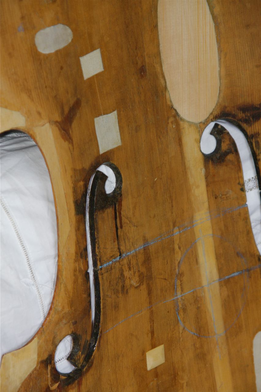

I have just started the top repair with a bass bar patch as the crack was really jagged and totally messy. Ill leave the final shaping of the inlay for when the bar is ready to shape.
The ROUGH linen patches are just for crack support until cleating.
My question is as follows - in the pic there is a chalked cross a few inches below bridge position and for some reason the top has sunk in just a bit over there . I thought this normally happened directly under the bridge feet but the top is nicely rounded where the bridge feet should sit.
Should I try and fit the bass bar over the slightly raised area or is it better to
try and heat press it out in a mould even though it is over a small and pretty thickly wooded area ?

Press it out flat and do it right.
Ken whats this obsession of yours to always do things right ?
  #64
Old 02-10-2011, 05:56 AM
Lightbulb obsession?
None, it's my advice to your question. Once opened, do the Top completely. Don't do a bass bar over a depressed top. The purpose of a restoration is to restore. It's your bass so do as you wish.

Keep in mind that a thick top table will not press. You may have to thin it considerably, press it out, then patch the result. Quite an undertaking!
