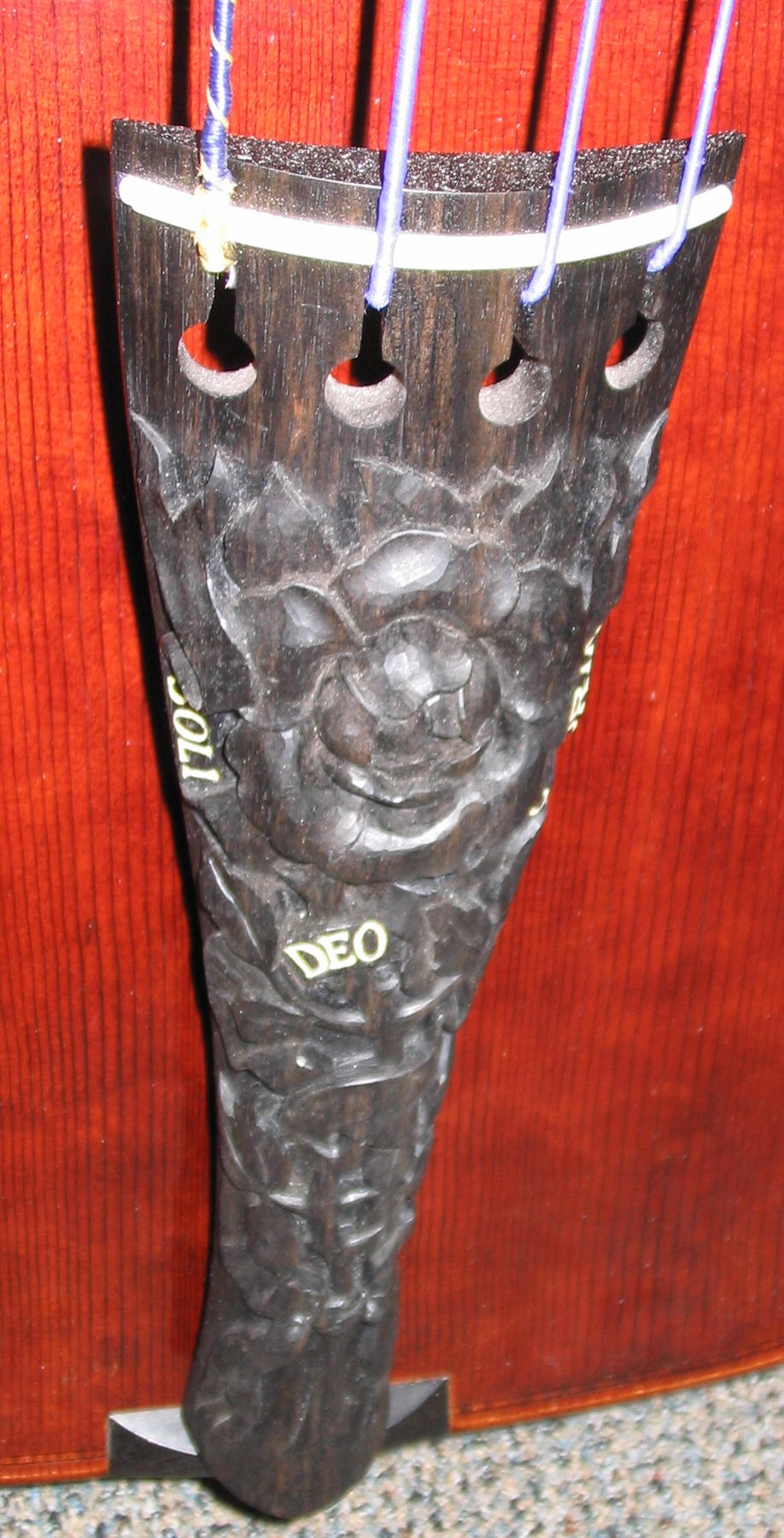

Here's a nice carved tailpiece by gold medal bass maker Dan Hachez.
Name:	carved tailpiece cropped.jpg
