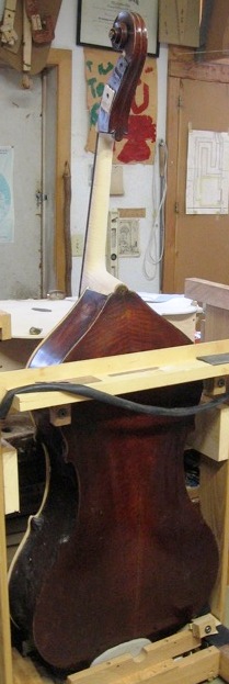

This Bass of mine is just coming out of restoration. It was nick named Scallopini after the 8 external scalloped corner blocks attached to the Guitar-type Ribs and joined to Top and Back Corners that overlap the Ribs. Next week I will pick up the Bass and bring it home, finally. Here are some shop pics I got thru email earlier.

The repair skills needed here were extensive. The Bass was un-playable when I acquired it and only played it for about 30 seconds before de-tuning it and putting it in the rack for repair. I have had this bass for about 3 1/2 years now. A good part of the restoration was un-doing the previous bad work done and re-repairing the Top which was in need of some serious surgery. The job took about 3 years to complete working on the slow side at first and then continuously after all things settled. The main problem was the Top which is usually the most fragile part of the bass.
The String length was longer before with the previous neck in the bass. It is now reduced to about 41" mensur with a D-neck heel. The back had some minor repairs done as well near the angle break and I also had a quasi small center 'sound-post' brace installed like on a Flatback bass. I prefer having this done on all roundbacks whenever possible. The Ribs needed some work as well. What ever work that was good was left intact but there wasn't much of that so most everything was re-done.
The Bass is now beautifully restored and I will be breaking it in daily over the Summer. I hope to play it in Orchestra next season. For now, without a C-Extension. That might be added in the future but if this looks to be ideal for a soloist, I might just leave it as-is.

Well, one thing we can see and take a guess at is the rib and lining bends. They are scored/kerfed inside in several places with the cuts going over the rib and lining together. Meaning, he glued the linings in first and then bent the ribs with the linings already glued in place. The bass is a match 100% all around and no 2 corners or scallops are 100% exact to one another. Totally a handmade bass. I would doubt a mold was used but some jigs perhaps to hold things in place along the way. This guy made guitars as well as violins. You can see his hand/eye matching when comparing the scroll button to the scallops. Same tools as well. Definitely an interesting bass to study.
The Top is 3 pc spruce with the pith down the center of the middle piece at the ends. The Tailblock area was deemed not worthy of repairing due to several voids in the original wood so a thru patch was made in a triangle shape. The point is about 12" above the saddle and the bottom about 5 inches across, slightly askew from the center line favoring the treble side of the bass. Looking close you can see it on the right side but the joint is well disguised on the left side under the tailpiece. In this case, we went for repairing that section rather then restoring it. Restoring it might have looked more original but structurally, it would still be weaker than a fresh solid piece in that less visible area. I have the piece that was cut out and it would need several repairs in itself as well as doubling it inside. The new piece was the cleaner and stronger way to go overall. The outer flank pieces join just inside the center curve/bout and along with the center piece has some very fine grain lines in spots. Definitely a cold time in history with all the tight winter growth lines. I would also guess this bass was made buy a younger rather than older person. This because of the mix of guitar work on a violin family instrument. Not quite a refined maker yet but extremely artistic. The Ffs are beautifully curved around the eyes. One of my favorite parts of this bass in its workmanship. The most favorite is the ease of playing with the small neck block angled in from the roundback tapered to just 4 5/8" (117mm) with the ebony caps touching the neck. A joy to hold and play.
The back is old Italian Walnut with nice broad flames. The center seam was repaired a long time ago, maybe more than once. It wasn't touched this time around other then some replaced studs along the center seam. The Ribs appear to be maple, fairly thick and with some slight flame in spots. Possibly Oppio, Italian maple.
