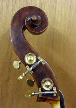

Hello all,
Here is a bass that the seller say is french and from late 19th century. He also says that the neck (and probably the scroll) is not the original one. What do you think? Does it seem possible to your trained eyes? It is right in my budget and I have been looking for a long time.
Thanks in advance for your insight
Francis

Originally Posted by Frank Larouche View Post
The scroll is in keeping with the bass. Late 19th to early 20th century is likely the period. The bass looks totally Germanic in style. The angled flatback is NOT a French trait at all. I think it can be German, Czech, Austrian or Hungarian but nothing French at all.
Maybe ask him why he thinks it's French like what part of the bass makes him think that other than the color.
Ok, looking at the front and side of the Scroll now I think this is Hungarian, same period of time, 80-120 years old or so, maybe less but not more.
Hungarian. That is my opinion after looking at all the pics, not German, Czech or Austrian and not close to French in any way.

Ok, this is a bit what I tought, I had never seen a two-piece flatback on a french bass. Do you think that it is all hand made by the same guy, or that it is a shop bass? I know it's hard to tell with only pics. If the bass is hungarian what is a pallpark in therm of price? 5 to 10k or it can fetch a higher price? 10-20 k?
The seller think part of it is french because there is a french label inside with the name of Paul Blanchard. It's surely fake.
Do you think the whole bass could be a new bass antiqued?
Thanks a lot for the answers!
Old 08-27-2012, 10:32 AM
The front of the scroll has very sharp lines so it can be new and antiqued. I would have to inspect the bass personally to give any more opinions from what I have so far but it does look Hungarian, old or new.

I've registered as a member expressly because I recently bought a very similar bass -- same varnish, same slender C-bouts, same FF-holes, same contour at the bottom back of the pegbox. My bass is also unlabeled.
The only difference I can see is that my bass has two-on-a-plate machines, rather than the individual machines on the bass Mr. Larouche posted.
If appropriate, I would be happy to start my own thread with measurements and (terrible) photos.
Mr. Smith, may I ask you to elaborate on your theory this is a Hungarian bass? I frankly have no idea what it is, but it seems to bear little resemblance to basses described as Hungarian by Nahrmann and others.
Many thanks in advance, and sorry for butting into someone else's thread.

On Hungarian, I have no clue what the others describe as Hungarian but the Hungarians are great copyists. I have seen all kinds of basses and models that when the dust settles, I see one or two things that tell me it's Hungarian.
This scroll is cut with the center line raised and the wood between the edges is flat rather than curved from point to point;
This bass here which is Hungarian and the underside of the scroll which has no wear from being protected is flat between the points as well. This is something I have seen on several Hungarian basses and never anywhere else.
