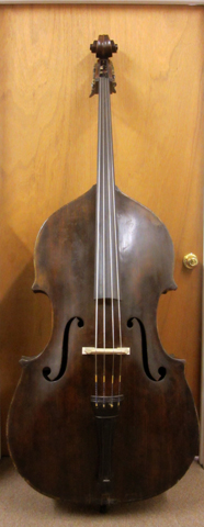

  #21
Old 02-16-2012, 01:08 PM
Cool Hawkes Composite..
I just recently bought an old/newish bass that was re-constructed around an old French Hawkes Top that was found in England with its original French Tuners. One way that I can personally confirm this is French is by the wood. It is the same wide and wavy grain often found on the Jacquet basses known as Silver Spruce. The Top was re-built around all for outer wings and also re-varnished in the process. Then, a fine Luthier in Hungary used Walnut that was cut into Back and Rib sets some 20 years ago re-made the bass modeled partially on the Hawkes pattern and even added the outer linings as found on the German-made Hawkes imports. The Neck with a short 3-string style British Peg-box was made new for the bass but he had an old Hungarian Head/Scroll lying around which he grafted to the top of the pegbox. Have a look;

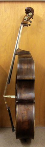

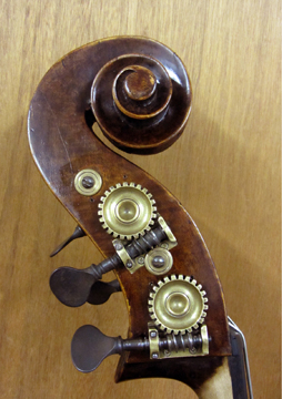

Received into workshop a nice "Hawkes Panormo" model roundback for restoration.
very nice smooth Baker style tuners
Has the H purfling, no outside linings, and a roundback.
It's in for scroll graft and badly needed top restoration. Back, ribs and blocks are in excellent condition.
The top is pretty funky. Lots of important cracks and a full edging required. And probably a new bassbar with cleats under!
It has some labels inside. But before showing these, knowing what we know in this thread so far, where do you reckon this one was made? (as if it matters to anyone but bass nerds)

This has no platform under the soundpost.

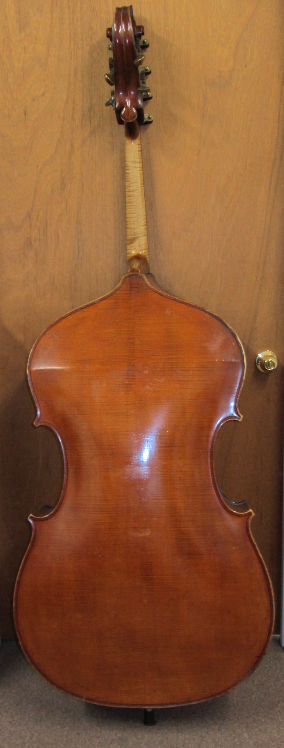

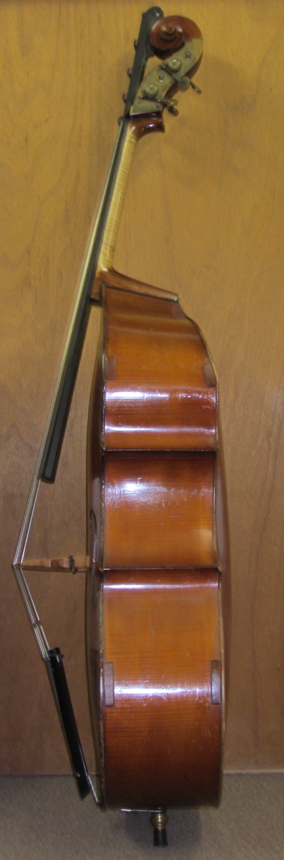

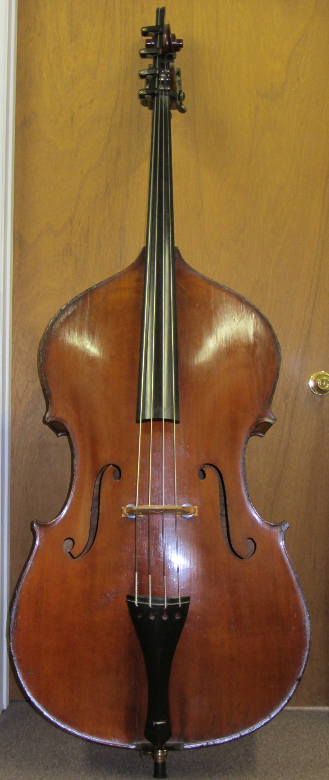

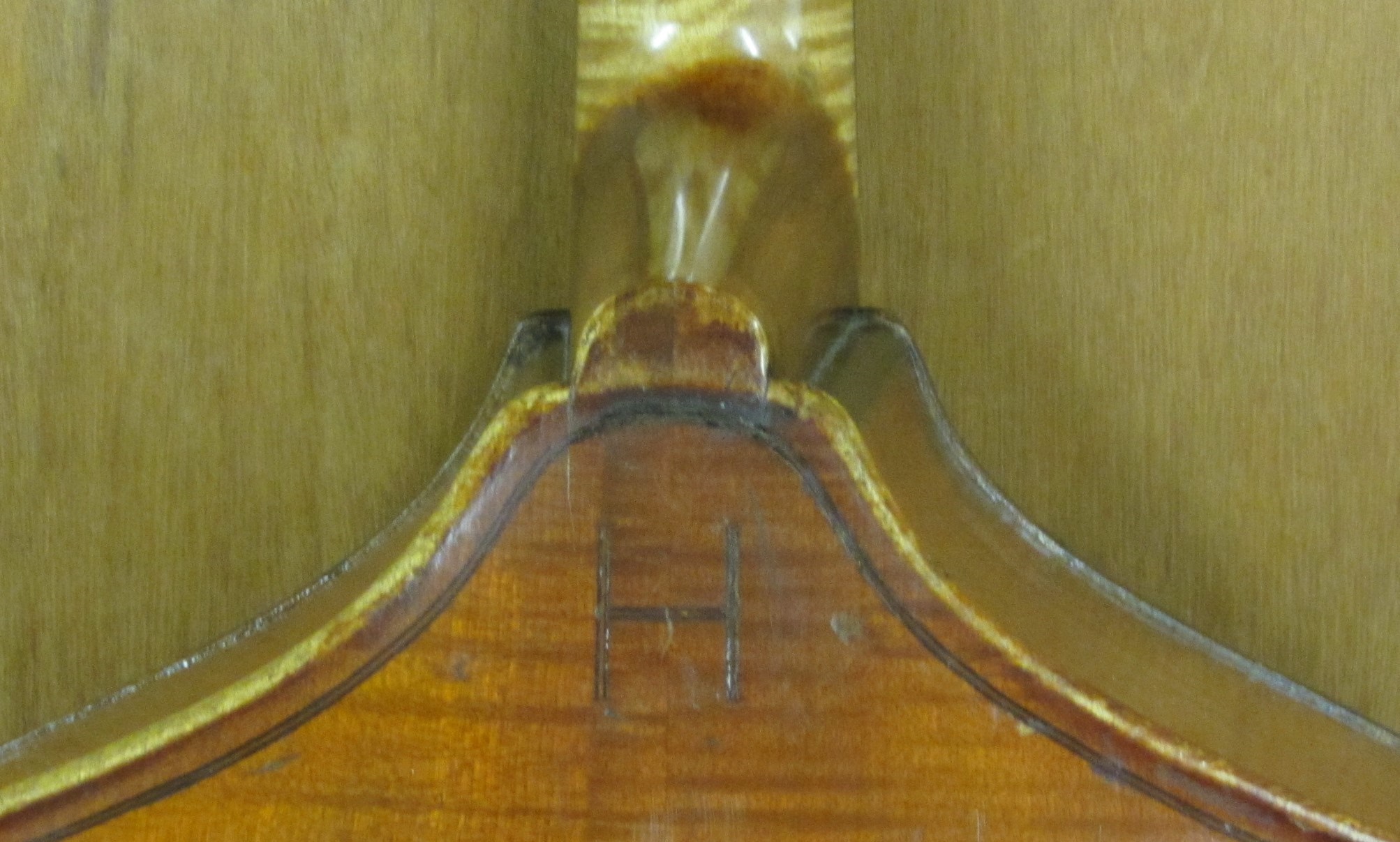

Arrow English Panormo 'H' model..
I have this bass here in my rack now and it looks very English all around. Label printed with Hawkes & Son, London 1921.

  #33
Old 10-14-2015, 11:01 PM
Neck graft and mensure shortened?
  #34
Old 10-15-2015, 06:42 AM
Yes, at it's last restoration. The bass came into the shop with a broken neck and needed work so it all got restored there at Arnold's. The owner then decided to sell the bass rather than pay for the restoration directly. I recommended the bass to a friend of mine and he bought the bass. Now, the bass is up for sale again. String length is 42" now. I don't know what it was before. The bass plays great as it is now.

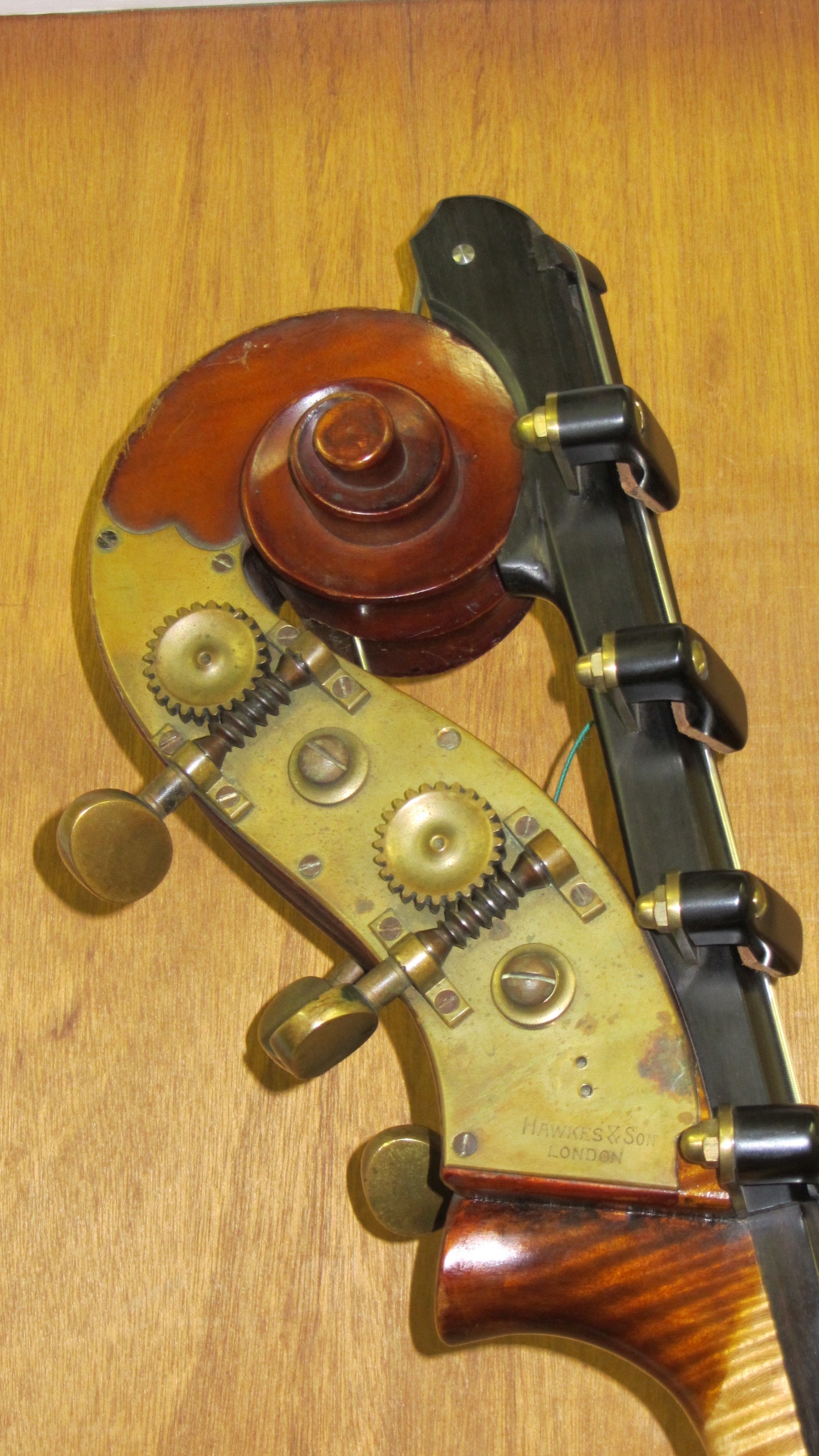

  #35
Old 07-16-2016, 10:41 PM
Lightbulb Update..
This English made Hawkes Panromo is now my personal property but still for sale. Robert Green is the supposed maker of these basses for Hawkes & Son. The later Boosey & Hawkes instruments were probably made in Germany as they were past the time of Robert Green who initially designed these basses for Hawkes as well as making the English Panormo model in-house.
The Bass has Pirastro Passione Starks on it now and what a thunderous sound it has.
