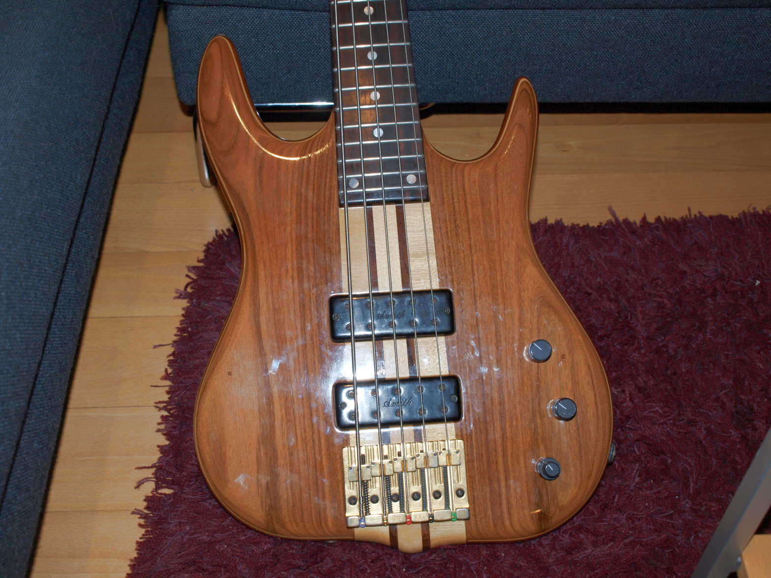

Hi Ken, (and other wood enthousiasts)
I have a question about the top and back woods on my '89 bt5eg.
Does Morado (which is the top wood i think) have grades like the walnut and maples have?
Because i haven't seen alot of Smith basses with a morado top.
And all the other morado tops have this dark yellow colour with a dark brown black grain.
Mine however has this very bright orange colour (as seen on this picture).

Does that mean i am blessed with a good grade of morado or am i less lucky and have a lesser grade? (The answer won't change my oppinion of this amazing bass and even better sound).

Cool questions..
Humm.. depending on who you ask the answers will differ. I have never graded my Morado Top woods or the Fingerboards for that matter. It either works or it doesn't. Not being a figured species by nature we just use Morado where and when we use it and not by grade. The wood itself comes from Bolivia and Brazil, has about 3 varieties that make it what it is (like similar maples etc) and varies in color as well.
On the Walnut Back, if it had a few more of what you call 'knots' it would be considered 'Birdseye' Walnut. Now, you have a rare piece of wood on the Back.
