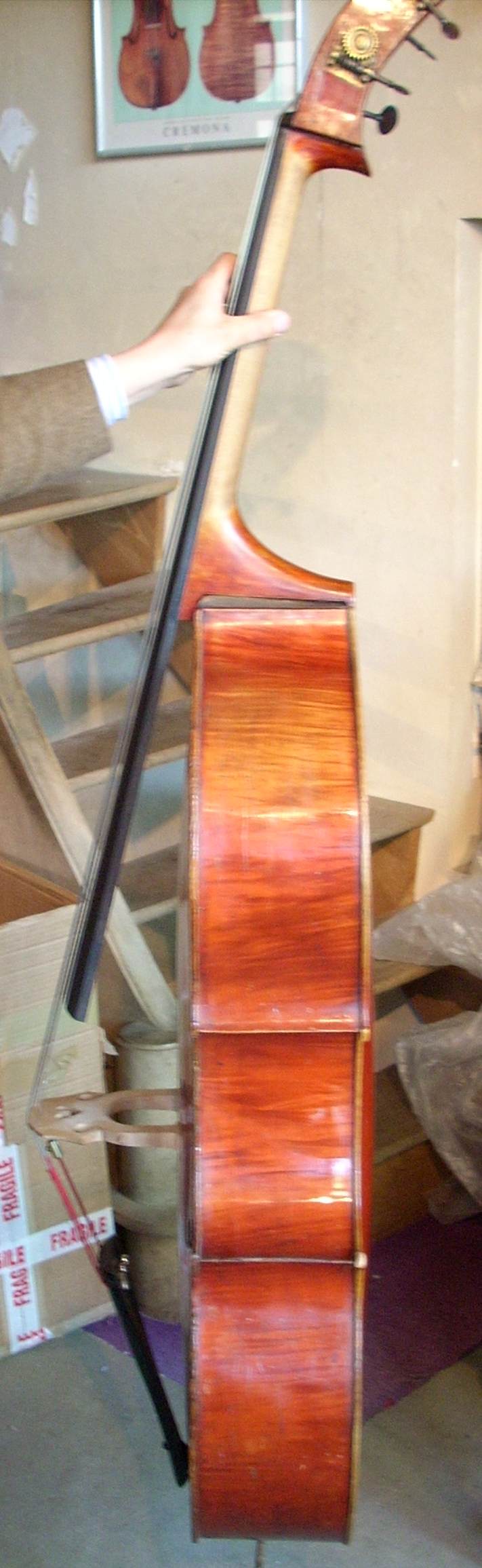

ok matthew, here we go.
iirc the bass had on original string lenth of 98cm (38,5")
the luthier changed the neck, now it has 108cm (42,5")
i will not comment this, if you have your own opinion what a well proportioned bass is, well...
the sound was a little to harsh and bright for my taste.
i´m not sure if its a real vuillaume. although the st. ceciles were a kind of economyclass-instruments, this one seems to be too less accurate made, imho.
i am courious what ken (and arnold?) will say.

Thanks for posting those Anselme
That is one peculiar looking bass, particularly around the neck region. Kinda looks like a regular bass with a "cello" style top stuck onto it. Is all that carving (double button etc) all part of the design, or is it a result of a reconstruction somehow?
From the side, the neck heel looks rather weird ... how to be sure where your D stop is with such a wide heel curvature!
looking again at those machines, they can't be original? sure looks to me like the whole pegbox has been reworked in an "individual" way.
mt
Old 01-31-2008, 12:44 AM
Cool Is all that carving (double button etc)??
mt
Matt, you need to get out more. That is THE typical 19th century French Bass, Violincello model. It may have originated as a design by Vuillaume but I see it on just about every French makers Violin cornered Bass from about 1850-1900.
