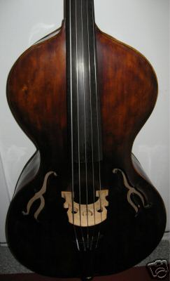

Here's one I found from Italy, c.1840 but reported stolen in 2002;
Label Vincenzo Lucarini
Fecit in Faentae 1840
I do not think that is Dennis' bass. His is squatier shaped in the lower bouts and I belive he's had it longer than 2002.

Cool yes..
I do not think that is Dennis' bass. His is squatier shaped in the lower bouts and I believe he's had it longer than 2002.
BG
I agree. His Scroll/tuners look different as well as the Varnish color if that's the same Bass on his website..
My main reason for showing the other Bass was to get a better look at one from that maker that I found on the net.

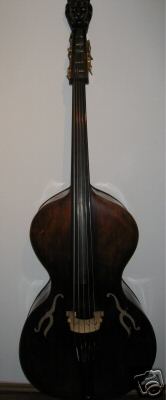

hm...well...ok...not spanish...not italian...
but cornerless, hungarian, and cheap
http://cgi.ebay.de/5-Saitiger-Kontra...QQcmdZViewItem

  #92
Old 02-28-2008, 07:13 AM
... and ugly! what's with the whacky ffs? Beurkh!
Well, Not Italian but it's the thought that counts. Figure that 'Cornerless' has been going on in Italy for about 500 years or so. Then we see it 200-300 years later coming out of Spain (that's just a guess). This just means that it's never too late for someone to start including the Hungarians.
With all the great fakes that have come out of Hungary in the last few years I am not surprised at all to see this. But those FFs.. YUCK! You are supposed to go to the Bar for a drink (or two) AFTER you finish work, not before.

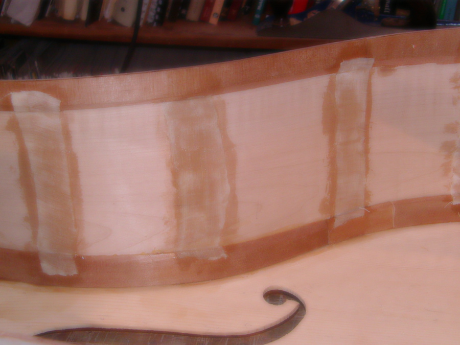

Hi Ken,
I think you do nothing good by putting braces in the ribs of your cornerless bass. The 90 degree attachment will likely lead to rib cracks, just like at the corners of old basses where the rib shrinks and the block stays put. If you are concerned about a small rib crack developing into a "zipper" and traveling around the whole body, you can run some linen strips across the ribs about every 8-10" or so. Put them in with weak hide glue and run them up onto the linings, otherwise you'll cause a new stress point where the linen ends. My experience is that these strips remain a tiny bit flexible, and while they stop small cracks from spreading, they don't cause new ones. I have been using this technique in all my handmade basses. Old Martin guitars have similar strips I've been told.
Good input, Arnold. Stradivari, according to Saconni, used linen strips in his cellos. He said in the cellos where they had not been removed those cellos still had no rib cracks.
(Edit) I've been thinking about this, and although I agree with your logic, the addition of braces isn't that different from having corner blocks, is it? I made a Benedetto style archtop guitar a few years ago and although I didn't put them in that guitar Benedetto recommended them along with the linings. It might help add some stability? I do like the idea of the linen strips. I used them in my basses and cellos for awhile, but haven't done so lately.

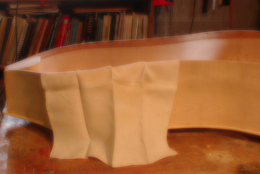

Linen linings in place on my cornerless bass.
Actually Martin, I did try some cross strips at first but took them out because I didn't like the feel. I think they made the sides too stiff. I had the ribs without mold and I could bonk them to assess their stiffness.
Just like Arnold, who advised me, I would advise you to forgo the wood and go with linen if anything.
