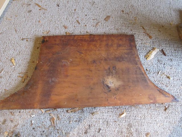

I've removed the fat brace from the back and what a nice piece of old spruce it is . It will come in super handy for the top repairs that are needed.
The back is in decent shape and Ill be inserting a centre strip throughout which means Ill need to remove a bit of back wood.
Im sticking to Kens ''do it right first time '' advice.
Now for yet another question or two ( if Im asking too much please tell me to shut up )!
How many back braces should this bass have ?And also is there an optimal positions for them ?
I've seen basses with 3 , 4 and 5 braces before ?
oooook , no bites on this one
So now Ill try and be more direct .
'' Is the Venerable Arnold E. Schnitzer in the house ? "
What really interests me is the middle back brace seeing that it is directly coupled with the sound post .
Are there any thoughts on maybe using lighter wood to facilitate vibration to the back plate , or would heavier wood be better better for some reason , or is it just a simple matter of there being no definitives here ?

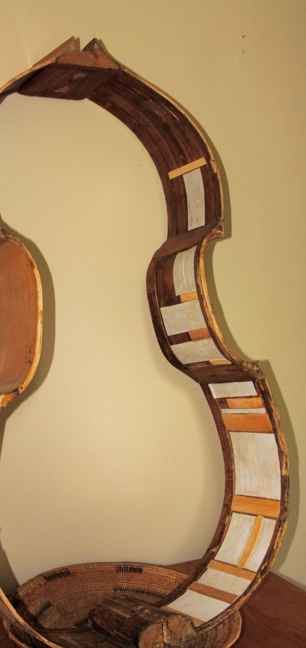

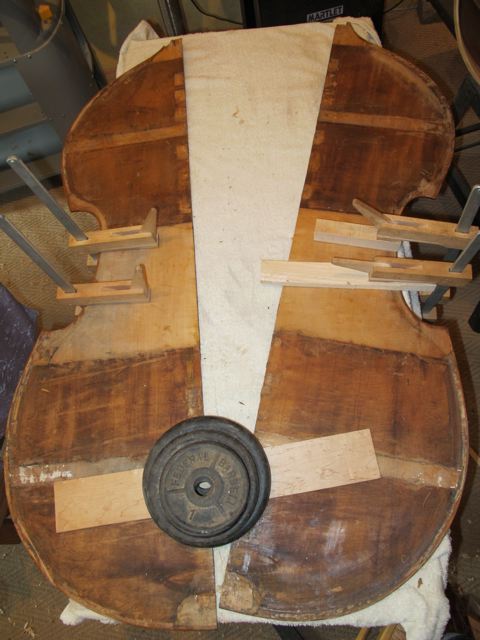

The ribs are now as clean as I'm going to get them without doing more damage to the damage.It seems as if the bass was about 50% wood and 50% epoxy.
The one lower bout is the only one left to reinforce . The other lower bout with the repairs was less than 1 mm in places and still needs the back edging to be replaced.
Now that the two pieces of back are flattened and ready to plane for an insert I'm not quite sure how to figure the exact size that the insert should be.
The back has shrunk a fair amount and to compensate the ribs were force epoxied in. The freed rib structure now spans about 20 mm more in its relaxed state.
Is it a matter now of lying the rib structure on top of the back to measure the space needed for insert ?
Or is it better to measure the back against the top for size ....?

Looks good. I would suggest fitting the Top first since it is the least flexible part and prone to cracking. The Back can be widened as needed but dry fit and estimate it first before making the center spline/insert.

That makes total sense and I just sat the top on the rib assembly and it is a perfect fit .I was worried that I may have to cut the ribs down to accommodate the top.
