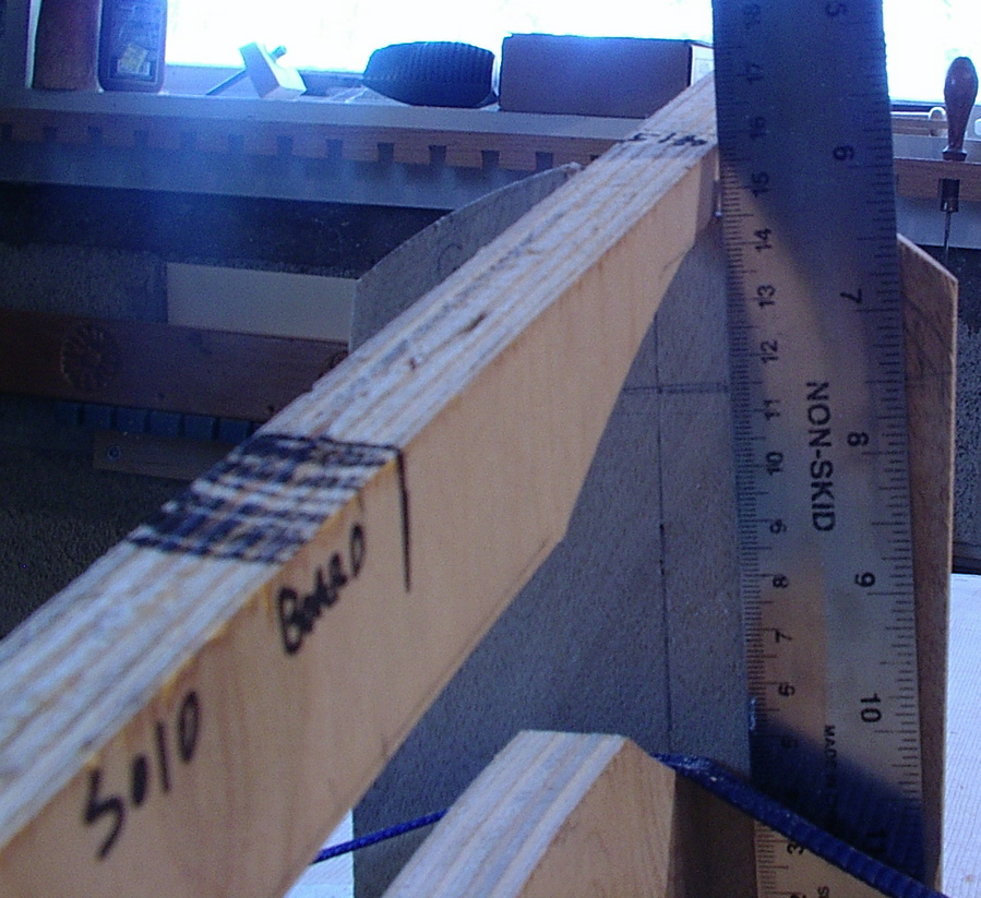

When setting a neck, what is the best way to determine the bridge height? According to the Treager book, on page 132, bottom left hand column, he puts a straight edge on the fingerboard, makes a mark on the bridge, then adds 5/8" of an inch for the finished bridge height. Does this sound reasonable?
Old 04-08-2009, 08:33 AM
Join Date: 06-29-2008
Location: Pompey NY
Posts: 110

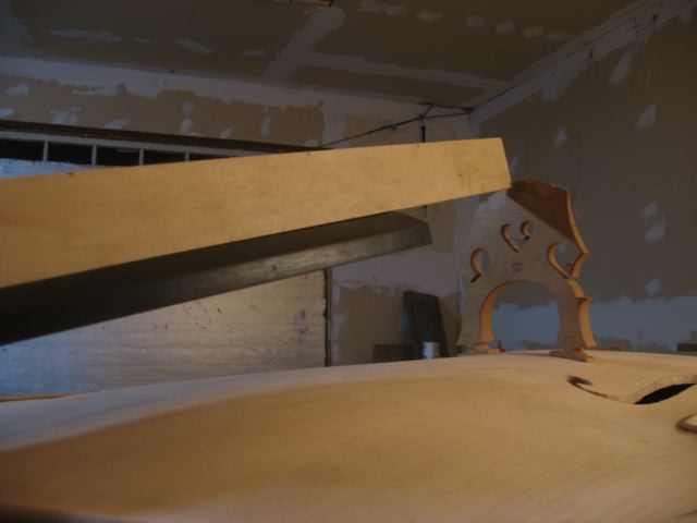

I put a straight edge on the finger board and made a mark on an old bridge at the highest point, this read 6 1/4".
6 1/4" + 5/8" = 6 7/8" bridge ht?
Here is a photo to help explain the procedure:
Thanks in advance.

The addition is more like 10-11mm, or 3/8", if you are going after an average modern steel string set-up.

So my straight edge on the fb should hit around the 6 1/2" point of the bridge to get a 6 7/8" (175 mm) bridge height?
Also, is 175 mm a good bridge height?
The bass is a Panormo copy, 170 mm spacing between the upper f-hole eyes.

Are you really using that bridge in the picture with the funny looking foot joint?
Thats just an old bridge I am using for set up. I like the swivel action!
I am in the process of cutting the neck angle and fitting the neck into to the mortise. The finger board in the photo is being held in place with a mock neck. This is to help me figure out all the critical dimensions like over stand, neck angle and bridge ht. Believe me, I'll be measuring more than twice.
That's a little high, especially if the top arch is high. If so, you are putting the bow arm far from the player's body and inviting shoulder stress. I think 6 1/2" to 6 3/4" is good for a 7/8 bass, unless the c-bouts are really wide.

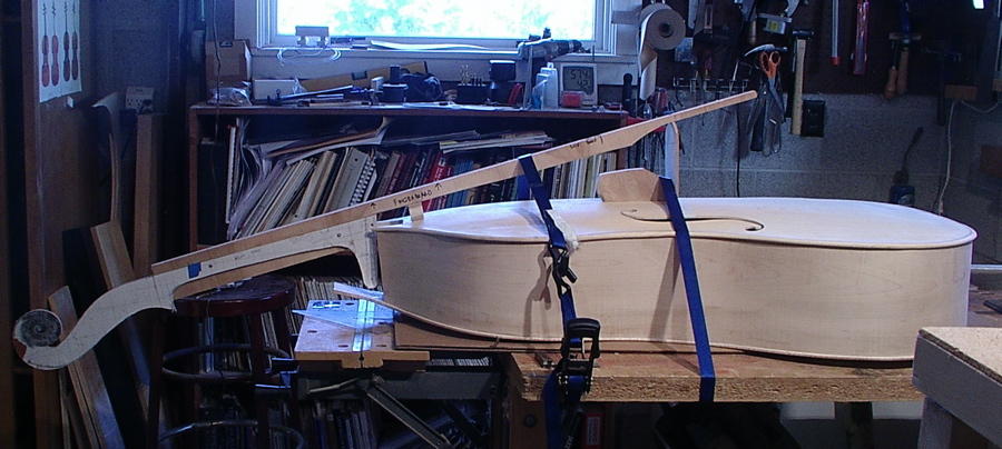

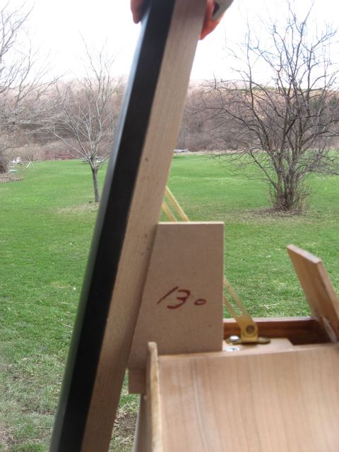

Hi Craig, Here is a sober opinion.
Since you are building the bass, start with the ideal numbers for bridge height and overstand.

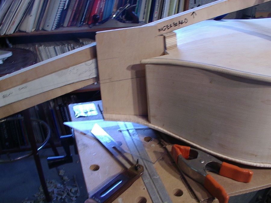

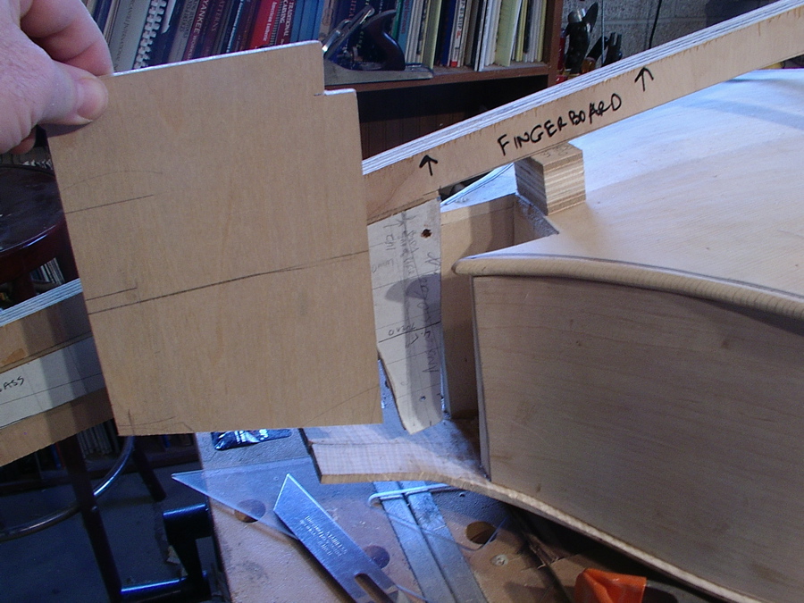

Use a neck template to find the neck angle.

Old 04-09-2009, 12:13 PM
Cool Ken?
30mm overstand? Is that what you have there? Quite low in my book. Most builders today use from 35-40mm. Decreases the angle of the Neck to the player and helps with the Top tension as well. Keeps the hands closer to the body when playing with less angle pitch I would think.

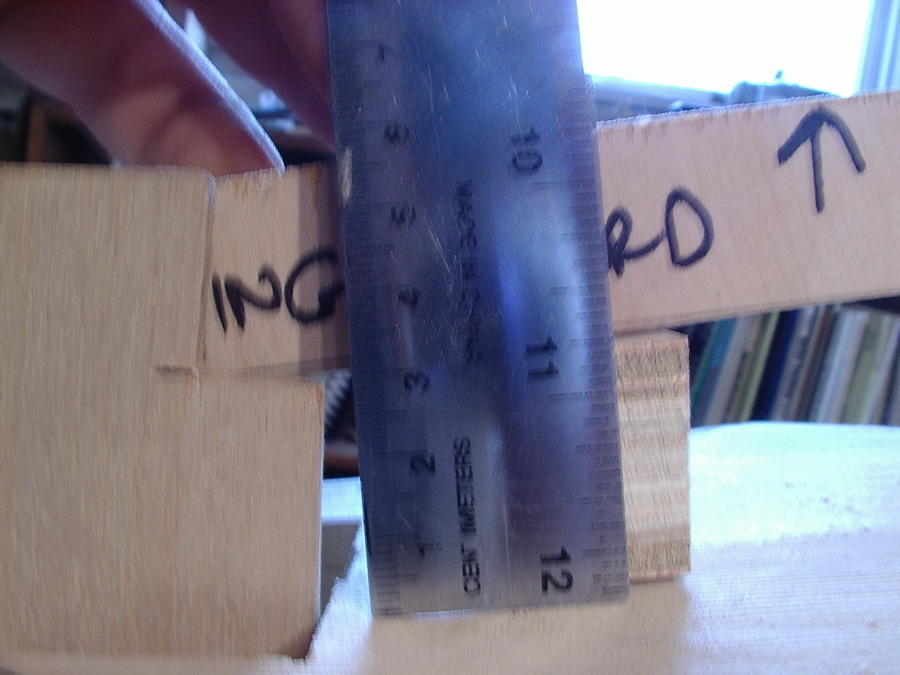

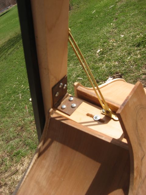

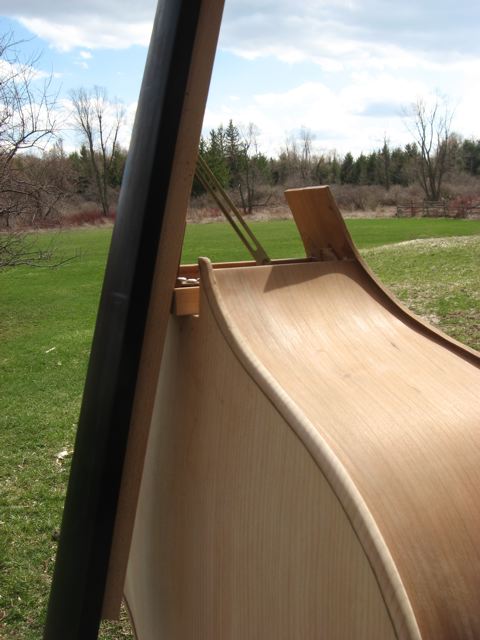

Still searching for the ideal number for the overstand. I set up an adjustable neck simulator so my "client" could see what felt most comfortable.
It moves in and out for overstand ht. and pivots for the neck angle. The screw in the neck block isn't very cool but I was very careful.

Came up with 1 1/2" Overstand, could be high but the bass is huge.

Minimum I think is 35mm and 40mm maximum for the overstand. Bigger shoulders might need 36-38mm as opposed to 30-35mm. Bridge height should be 6.5-6.75" at the center with lowish string height. This is my personal preference.
