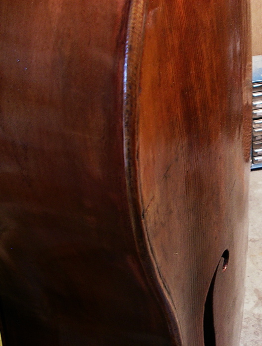

Ken, I did look at it and listen as well. With Varnish the sound will soften up quite a bit as it does sound a bit raw now. EP strings are not the best for smoothness either. BelCantos are about the best for that for Orchestra. Jaegars if you can find a set is dark and smooth as well.
Now, the lip of the Top and Back overhanging the Ribs looks quite proud. Is this finished that way or still to be trimmed? How much does that Lip actually measure? I can't tell from the pictures but it does look big. Also, the linings inside look about double width as well. This I think will stiffen the Ribs and possible rob some tone as well. I am sure you are not totally done with this bass inside as well as out but since you asked, I am giving you my personal opinion as if the bass was being delivered to me personally. After all, would you want any less from me since asking? I see he tuned down to 'D' as well on the 'E' string and it sounds good. That's always a good sign in my book when you can de-tune and still have a strong open string sound. The Back Bracing looks a bit overdone but only time will tell. I have never seen anything like that myself. Maybe the heights of those 'Bars could come down as well

Thanks Ken Smith, I did expect the honest opinion and thanks for your comments on the overhang and lining.
The lining is 1 inch and is made from cedar. I will not use it again because it is too splintery when the top comes off it will not be good, live and learn. The overhang on the photo you linked to the top was not quite finished. There is a healthy overhang though, but it is not perfect all around, it varies a little here and there. It blends in with the other imperfect things on this bass

Here is the start of varnishing and antiquing. You can see the overhangs better here.

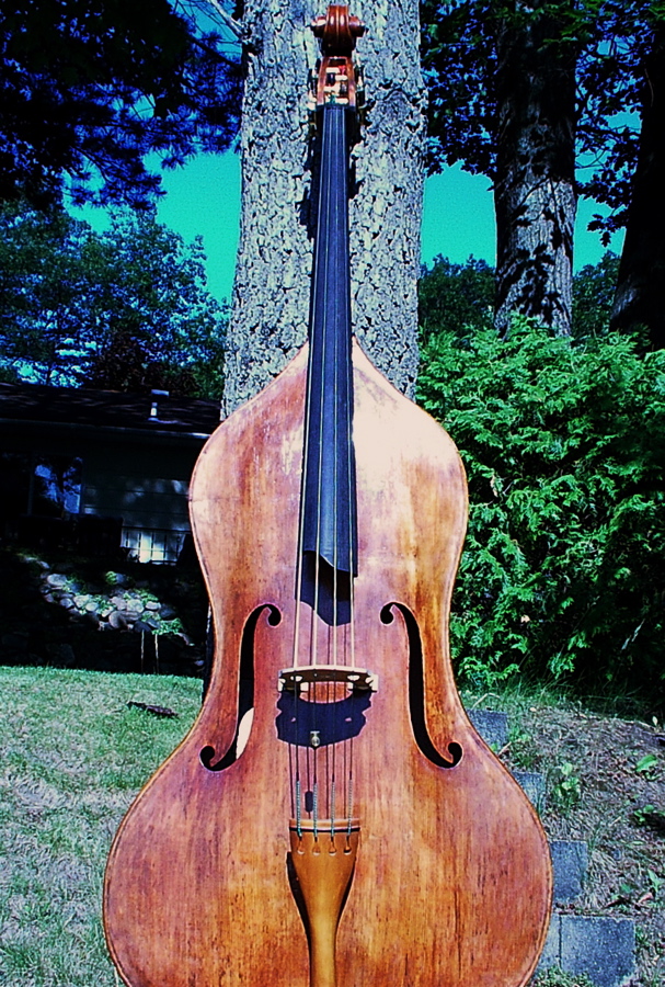

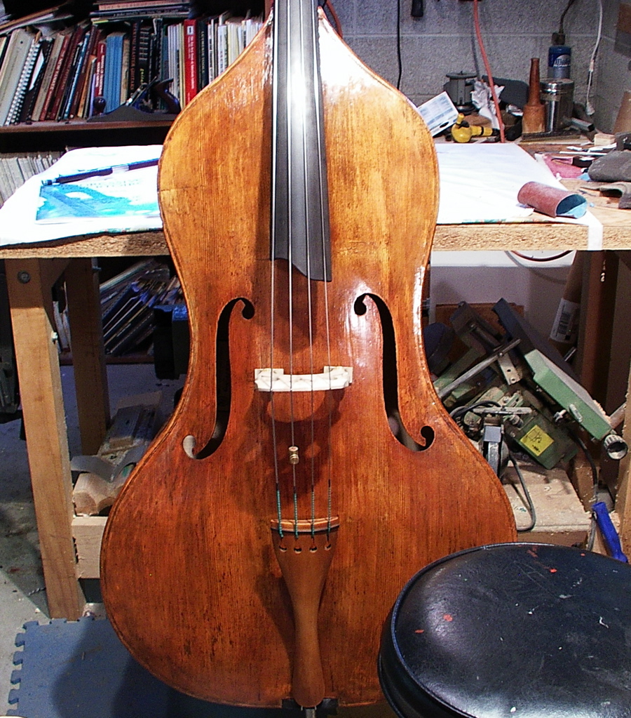

Default Pasquali is finished
Here it is http://www.upnorthstrings.com/cornerlessbasspage26 read about it here and let me know what you think. It was a very interesting project which I might like to try again, not sure yet. I like the sound and the way it plays and what more could I ask.

Hey Ken could you tear yourself away from your Martini long enough to take a look and hear the sound with varnish? I think it makes a difference. It may be a bit fuller and mellower, not as harsh.

I remember Arnold showing me a bass he made a couple of years back. He mentioned that he wasn't happy with the sound a 100% when it was done so he added two more coats of varnish and 'that' warmed it up tonally. The bass sounded beautiful and in no way sounded new at all.
Your bass sounds great raw or varnished. With varnish I feel it has slightly less string edge but that is with listening on a tiny computer speaker. I am sure that you can hear the difference better in the room, live. So, how does it sound? She/he looks great, the bass itself that is..

Thanks for listening.
The bass is strung with Evah weich's and sounds slightly less edgy with the varnish. I have not strung it with anything else because it seems to like the EPW's just fine.
The player is Josh Allison, a young former student at Interlochen and now at Trinity college. I always enjoy listening to him play. He will be in the market for a nice orchestra bass when he graduates.
The nice thing about my new cornerless is that I have not had to do much of anything since the initial set up after varnish. The bass played well right out of the shoot. In the white when first strung there was a loud wolf on the A but went away with the brass afterlength weight.
