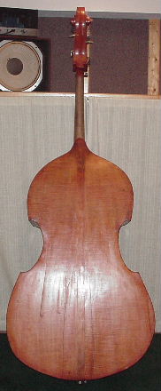

I'll attach a few photos in my next post. I guess my question is - what kind of bass is this? I've heard both Mittenwald and English. Photos to follow...

Old 07-05-2009, 09:34 PM
Cool humm
Interesting stuff here. All of the English dealers after looking at pics of my big bass said it was English. The first time I saw the bass and examined it in my office I was getting brain flashes in my head.. German.. no, English.. no.. German.. no, English.. over and over again as I looked it over.
I too have seen some other Basses 'on-line' that have sold as English but looked a bit German as well. What are they really? Well, let's look at a few things here first..

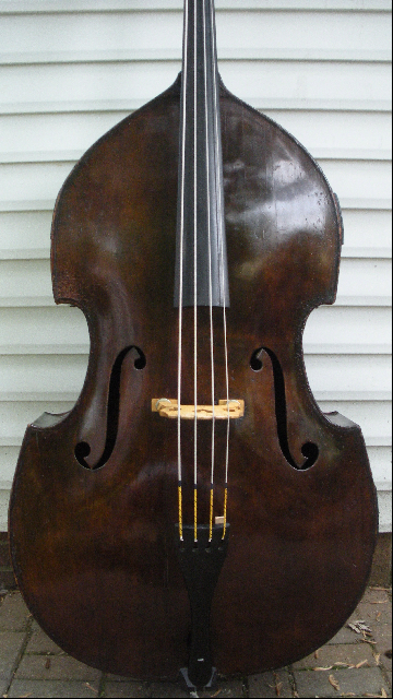

Hi Ken,
Here are some photos:

Well Jeff, aside from both basses you show being Gamba shaped I don't see much in common between them.
Better pics of both might help but I need to see Ribs, scrolls and Neck/block area as well.

Am having trouble loading photos. Here's one of the side of the bass.
I'm not suggesting that our two basses are the same... I just got
very curious about your mystery bass and the idea of the large Mittenwald basses. More to come when I can figure out the picture problem.

What I meant was that the two you posted are different. That's all. The first one does look like a Seitz I saw a few years ago on a German website.
The Gears on your bass are nearly identical to the ones put on mine after it was converted to a 4-string. I shipped them to NY and trying to get them back now just to have. The plates on your I have seen pictured before on a few German Basses. One had the same exact gears as well.

I don't know what it is but most of the older English Gamba shaped Basses I have seen had broader shoulders and not sloped like your. I don't see a Seitz connection but maybe one of the Neuner's if it's Mittenwald. Are the Shoulders original or have they been cut?
I would have loved to see and play this Bass. Most big basses have less than friendly shoulders to match. Your Bass looks like it's easy to get up into thumb position without much stretch.
