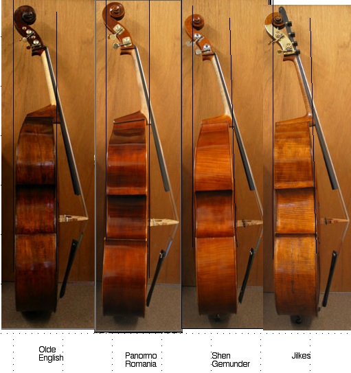

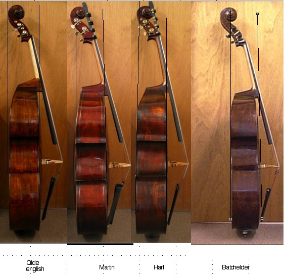

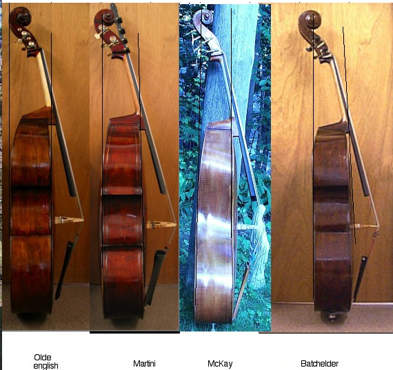

Another thing is the angle of the neck in relation to the back.
I am asking here. If the neck angles back too much it makes it hard for the left arm and the player tends to want to lean back while playing in first position and then forward when going up to the higher positions. Right?
What are some landmarks in regard to this? I might need to do some drawings.
Old 07-12-2009, 10:02 PM
Lightbulb Neck angles and comfort..
Not quite off topic but rather a very important comfort factor that is usually not even considered and we take what is given to us. Here are some pics of my basses for the sole purpose of looking at the Neck-to-body angles. I don't know the angles but there is so much else to be considered along with this for playability. The top arch, the center bout width, the back length, the rib depth at the neck and mid upper bout that may touch your body and the top and back lengths respectively with how the neck must be set as one plate is often longer or shorter then the other. Here we go;
Have a look at these and compare. Feel free to ask me which are easier to play standing and/or sitting. I hope I can remember them all otherwise I will have to test them and report back. One of them is out in restoration but I remember it fairly well. Have fun..

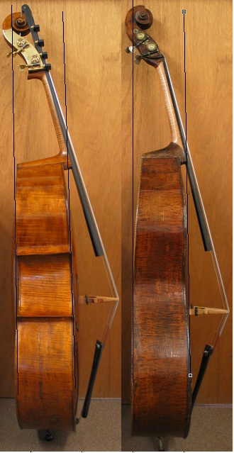

KS I see you did a lot of work putting up the side views.
I captured these basses earlier and put a straight line from the back up to the scroll to illustrate the angle differences, then I added the front line to create a "box" where the nut sits inside.
I did this last night but didn't post it so here it is. Pretty much the same as yours but with the lines. You obviously don't need the line, you can just look, but it does help define how far the fingerboard is out from the left hand.
Question: Is the distance from the imaginary line up the back in relation to the nut (just where the strings exit the fingerboard, a variable to control? When designing or restoring a bass where the neck will be reset the overstand can be varied by adding some wood to the heel (or removing). A bigger overstand will allow the nut to move more away from the imaginary back line and visa versa.
This reminds me of the old Sesame Street game "One of these things doesn't belong".
Well, it was not much work for me because they were just from the page shots we took awhile ago. Nothing more than copy and paste for me here.
So, as far as you can see, which basses have the least pitch, most pitch or most comfortable 'looking' pitch in your mind for what you can see.
As far as what can be controlled, often in restoring an old bass, the string length is something we try and control in the planning. Making it longer, shorter of keeping it the same. Sometimes they are re-pitched slightly and sometimes not. Some times they are set lower into the block and sometimes just moved out.
All of these steps are possible to do but what ever is practical for each bass to achieve the desired results is what will be done. The optimum achievement can only be done with a blank check so to speak. You cannot do this 'on the cheap'. The bass needs what it needs to get it as good as IT can be for today's playing styles. Sometimes it's very little and sometimes it's everything.
