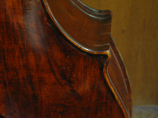

Hi, after considerable thought on the matter I have decided to go ahead and have the Riccardi 'Storioni' copied. We don't really know what makes this bass sound so good even after taking it apart but if I were to have a bass made, I would want it to sound and feel like this.
This bass will start construction this Spring and be completed within 6 months or so. Even though I have a good idea of what I want as far as the degree of the copy stage and modifications as well I thought it would be interesting to discuss it out here and see what you folks think of the idea. Also, if this were your bass being made would you copy it 100% as it is now or modify it in some way. Please share your thoughts.. |

Here is a pic of the Scalloped outer Block bass we call 'Scallopini'! ![]() Now, an important thing Arnold mentioned was marketability. For an Italian Bass over 200 years old made as it was made and with the reputation of sound being well known and rememberd by all that have heard it in the last 40 years we can accept this particular Bass for what ever venue the player brings it to. For selling it, it is a known classic Italian Bass with a sound to die for. In making a brand new Bass today and keeping the re-sale thought in mind, putting corners on the 'modified' copy along with several other changes to the original Bass to meet todays needs in both playability and marketability. |

I have used the original in Symphony concerts so I know very well what I would like if I owned a twin with the desired modifications. This is it, the twin, modified! You would need wood from the same boards as this to make it exact but even then, it wont be. Only the exact is the exact. I know David's copy BUT, to my eye it is more of an inspired copy than a copy copy. It was made with Walnut, different Scroll, different FFs and, he didn't have the original apart in his hands at his disposal to copy from. Arnold has heard the Wiebe copy and it doesn't sound like the original. Perhaps nothing will. The original has been re-graduated within the last 100 years or so and we have to 'guesstimate' what the original thicknesses were. Actually, the bass is currently 'reverse-graduated' The bass is thinner now in the middle and thicker (original) around the outer edges as the center was cut up quite a bit. We will use something more traditional and maybe tap tone the Top along the way making it to the actual wood chosen. We will have to ask Arnold when all is done how he arrived at the final thicknesses. I say we but 'I' am not the maker here. Arnold Schnitzer is. The 'we' is us, maker and player/designer but without 'me' commissioning this, it would never happen. On the Ribs, they will be solid, not laminated. We can see now how cross grain Spruce against Maple reacts after 200+ years. Not something I want to see in my lifetime. I will however have the Rib depth and top to bottom tapers copied. This will not be a very deep bass at all. It tapers 7 3/4" to 5 3/4" Block to Block. I asked Arnold to copy as close as possible and make the same Purfling as well. I also want that Scroll/Pegbox copied. It might get slightly extended in length if it helps fitting the C-Extension as this was a 3-string. How would this maker have made the Pegbox if it was to be a 4-string originally? This is in thought for now. We can use the Original to measure from and decide from there. Maybe we need to have a mini-convention of all the recent Cornerless Bass copies and inspired models which this one actually is. I am not all that concerned how much the corners will affect the sound. The inside lines of the Bass will flow in the manner of mainly a Guitar form. |
