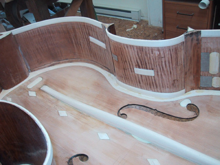

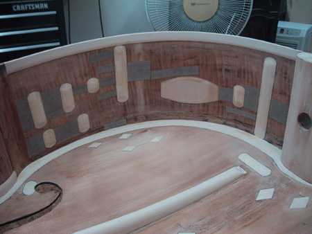

I have some pics on my website of the Gilkes and Prescott inside with Bar pics and shapes. The Gilkes is a full 3/4 or so and the Prescott more of a 4/4 size. I did have a small, thin, short bar in my big Gamba English bass and we left that in. The Top was perfect so why change it. If later the Top sags, a bigger/longer Bar can be put in. For now, the sound and arch is great, no complaints. The Gilkes Bar was put in by Arnold. The Prescott looks to be its secondary Bar and very old. Arnold did trim it slightly but there was no need to replace it.
