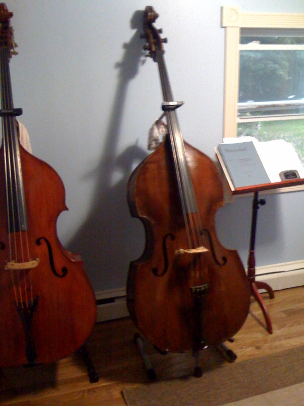

Hello!
I just picked this old girl up! She needs some restoration work and I'm shopping around to see who I want to fix her up for me (new bridge and probably take the top off to repair a few cracks in the top). Not much sagging in the top and otherwise looking pretty healthy!
In the meantime - I'd love to get some thoughts about where she might have came from! She has a sticker inside that says "Made In Germany - Made in Germany" but this looks too new to be original. I'm thinking a late 19th or early 20th c chech or bohemian . Any other thoughts?
I know I probably need to add some more photos so let me know what might be helpful. string length is 42 3/4!
Thanks

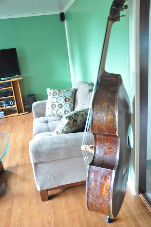

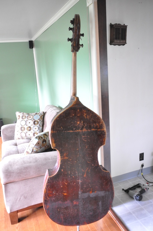

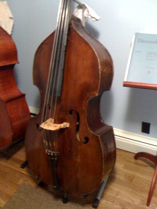

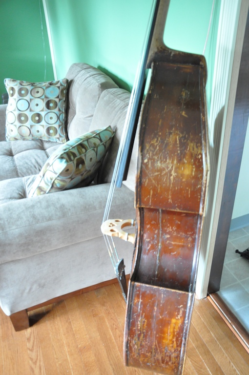

Default More photos
more photos

Old 06-25-2010, 05:04 PM
Cool humm??
Well, the first thing that puzzles me is the varnish color and texture between the Top and the Back (as well as the sides and Scroll.) Usually the Top would appear to get older looking first but in this case at least from what I can see in the pictures it appears that the Back is older.
Ok, ok.. varnish issues aside as we don't know what's original, gone over or re-finished even, the Bass itself looks German from the 20th century. I would guess from just the pictures 50-100 years old, no more, no less.
Basses like this that were used in schools rather than in professional orchestras or something in between may not have been cared for so well over the years and the repairs maybe less than Strad quality work to say in the least.
Basses from their size and make qualities (of lack of) can age quite fast. Especially being banged around and then patched up by some fix-it guy or with that mentality because of the value of the bass at that time.
Bass like this when made could have sold for under $50 new and up to maybe $100. Flat back with little to no figure were at the low end. Unpurfled basses even lower. I have some old copies of import catalogs from USA distributors and you would be shocked to see what some bass sold for. Sears had Blockless Tyrol/German? Basses for sale for $7. a month. Yes, SEVEN DOLLARS or $75.oo Cash if paid in full at once. That was in 1937 just before the War. In 1922 Wurlitzer, a more exclusive shop for fine Violin family instruments was asking $90 to $180 for the best quality for these Tyrol type basses, slanted ffs and humped rib/neck joint hence blockless. Go figure!
It is possible that some early repairer refinished just the top and left the rest as-is. I have seen many bass Tops or just Backs refinished after major repairs and I am not talking student grade German import basses here. I mean fine old Italian and English masterpiece basses in the 6 figures now in value.
So, looks like old German/Bohemian, Markneukirchen/Shoenbach, northeast German/Czech border area.
Is there any figure in that wood, back, sides or scroll/neck? Is the neck grafter or original one piece? Any purfling in the Top of Back edges?
Measurements? My DB web pages show the normal areas to be measured. Ribs are ribs/sides, measured themselves inside the top and back as made and not including them. Bout widths, top and back length, string length and rib depth. These are the main numbers. Basses were made then as 1/2, 3/4 or 4/4. There were no basses made in commercial shops as 5/8 or 7/8 size. That is only an interpretation used today for marketing.

Old 06-25-2010, 11:00 PM
Lightbulb wow..
oh and no soundpost crack.....
The more you tell me the more I think this is 20th century rather than 19th century. The overall shape with the outer linings combined convinces me that my first impression is correct. This bass would be more of a German Shop bass than German School bass so this thread should be moved to that section. Imported basses recieving labels reading 'Juzek', 'Pfretzschner', 'Morelli' and the like are all re-branded Shop basses. I don't know what this was or when it came over here but it is along those lines rather than a hand made bass from a single maker.
With the body size and over 42" string length I would classify this as a mid-wars bass (between 1920 and 1936) German/Czech/Bohemian Germanic style Shop bass. The different colors of varnish are most likely altered by 'improvers' of the past.
Wait, not soundpost cracks? Look again. This thing is split all over the place. I would get in there with a light and mirror. It looks like a huge old crack pretty close to the Post and should get a post patch type repair to play it safe.
This Top has a crack near the soundpost, one coming up from the saddle towards the post and on both sides of the bass bar. You asked about its value fully restored? That type of work might easily exceed its value I am sorry to say.
Some refer to basses like this as 'players instruments'. Although they will never make it to the Museum, they will work well in the field in general.

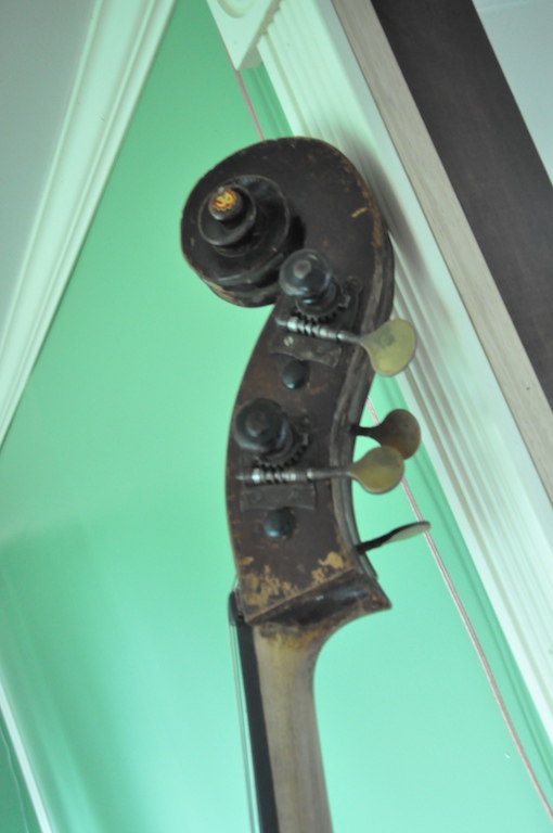

Old 06-26-2010, 12:43 PM
Join Date: 06-25-2010
Location: Ithaca, NY
Posts: 21
Ken: What do you make of these tuners? They look original and that is what is throwing me about ago - I usually see those on older basses? Were they still using them mid-war?
Thanks!
Old 06-26-2010, 12:59 PM
Cool yes..
Thanks!
Even post WWII, if they were in stock, they got used. Used sometimes I assume to make the bass seem older. Never date a bass by tuners alone. Putting old tuners on a new bass is not that uncommon.
