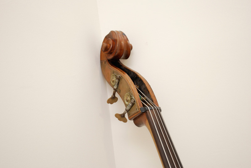

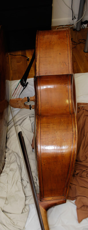

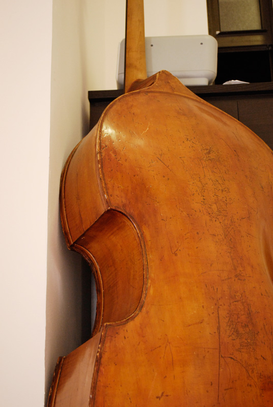

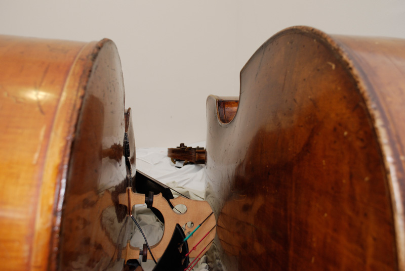

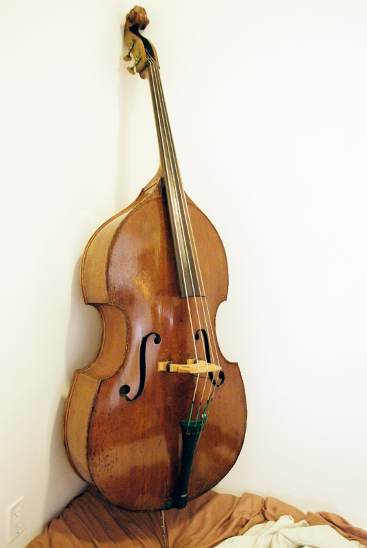

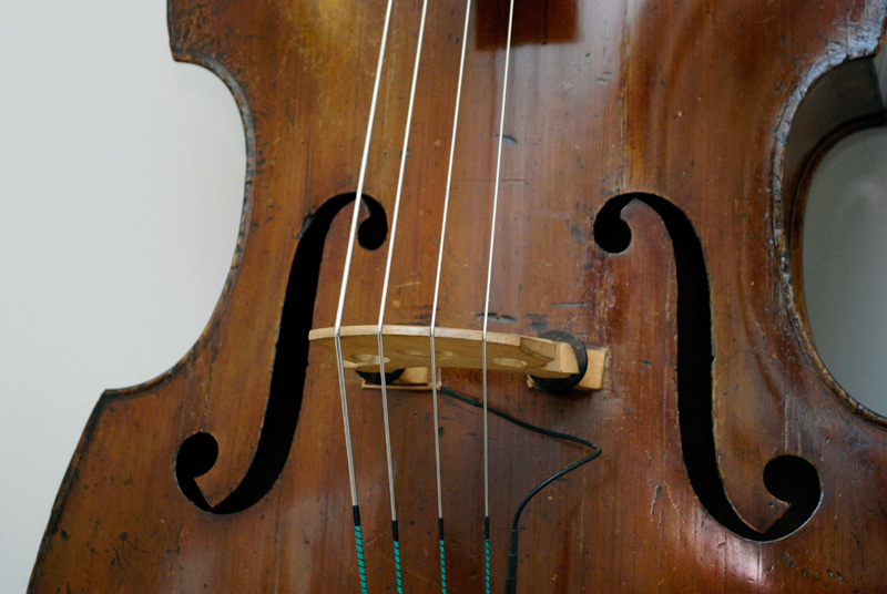

Hello everybody,
first of all this is my first posting on this great forum, and I hope that some of you might have some input!
I was offered a bass which is in good shape, supposedly German and around 80-100 years old. All repairs seem to be done well. The bass has a destroyed German label of "Wilhelm Uebel - violin & bass repairs and...(something like that)", hard to tell if that's the actual builder or someone who did repairs in the past. Another label is from Kolstein (I guess I should go and ask him too after the weekend): Restored in 1999.
I didn't take too many pictures, but you hopefully get the idea. The body seems to be 3/4, maybe even slightly on the small side and sounds puts out a lot of fundamental for it's size, good projection, very articulate and great lows, especially when played pizz. Scale lenght is 42,5".
The asking price is 10k, and even though the bass seems to be a bit more sophisticated than many generic German shop basses I've recently tried (another thread on those to come), I'm not sure if the price tag is justified. I know it's gonna be hard to judge from the very few pictures, but by the time I had it at home for trial I didn't feel like taking too many photos, would become handy now.
Any input on this one?
Johannes
PS: On the picture with two basses it's the one in the front. I hope you don't mind the mess of sheets underneath, didn't expect to make these accessible to anyone. ;-)

It is a German Bass in the 100 year range. I have a bass about 99.99% exactly the same. I would venture to say from the same shop in Germany. Mine is in restoration so I can't show it to you but it is just about the exact bass. For a moment, I looked twice to see if it was mine but it's not strung up yet. It was poorly restored in the past which caused its current internal collapse. It too has a Kolstein repair label. It also has an appraisal as an 1860 Mirecourt French bass. Although these are French type solo model influenced basses, it does not make them French. The outer linings on your bass and how it miters across the neck joint is typical German work. The appraisal says typical Mirecourt 'lipping' which I don't subscribe to. I have never in my life seen a certified French bass with outer linings. French looking basses with outer linings are made in Germany.
You have there a German bass from about 100 years ago or so and that is a fair price IF the work inside does not include a sprung bass bar which mine did or a sunken top at the bar side or any other damage that would cause it to need the work done over again but correctly this time.
If you can borrow the bass and take it to Arnold, Jeff or myself you will be able to get a good idea what the bass needs or does not. There is no one else between NY and Pa that I would add to that short list for review.
Getting opinions on line as to the worth of a bass on the internet is no better than getting medical advice and acting upon it afterwards.

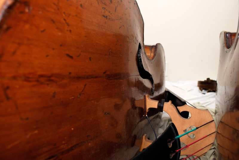

I also mentioned bass specialist maker/luthier Jeff Bollbach. He is in Long Island and one of the few that I trust with my best basses. Go see him with the bass being that he is closest to you.
On that pic of yours above you can see from the F-hole sticking out that the Top wood is below it. That means it has sunk by the bar. Some basses just settle a bit and safe to leave as-is. It is that needed trip to a luthier like Jeff that will let you know if you are safe or not.
On my bass the string length was also long and closer to an Eb neck. The only way to make it more marketable in todays world is a new neck graft shortening the playing length overall. My goal is for 42" or slightly less.
Is there any way to show a pic of that torn German label inside. There are many makers named Uebel in the 18th and 19th centuries but only one listed as W.Uebel in the last quarter of the 19th century, not listed as Wilhelm though. He (W.Uebel) was from Markneukirchen Germany which was later East Germany on the German/Czech border. I suspected my bass to be from that area rather than further south in Mittenwald mainly because of the roundback. Most old Mittenwalders are Flat backs. There is some slight possibility that his shop made these basses of ours but also a 50/50 chance at this point he either repaired it or the lable doesn't belong to the bass. The dates of the late 19th and early 20th centuries pre-WWI fits W.Uebel's period as does the area in which he worked.
Another larger Orchestra model Bass was sold not once but twice as a 1850-60's French Parisian Bass by another big shop in NY in the last couple of decades as well. I had a chance to examine that bass and could see just as with our basses how a dealer could 'loosely' call it French but in reality, the work is totally German. Style of design does not make it the nationality of its looks. It has to fit the work. When you see a bass like that regardless of size or design with outer linings and it is marked as French, be on the alert that this is probably 10 out of 9 times false.
Many fine basses were made in Germany that were not Shop or Factory basses but rather hand made instruments just like a fine French, Italain or English bass only it's German. Many of the nicer German basses are called something other than German, possibly for profit reasons but also due to mistake in identity. The countless factory basses imported to USA in the last century has clouded our judgment as to what a better quality German bass might be.
One more related story if I may. I was at the first rehearsal (of 3 or 4) for a Mahler 1 concert in which the orchestra was enlarged for this production and 3 new basses were hired in as subs. The guy on the end (I placed him there..lol) had a dark varnished sloped shouldered bass like ours but with a flatback. It had 100 year old Mittenwald gears on the bass like those I have seen on Neuner & Hornsteiner basses, the exact ones and the purfling ran all around the top and back as well like on French basses and our twins as well. So, to poke around I asked him on the break "hey, do you happen to know what pedigree your bass is?" asking him in a respectful manner as he was a total stranger to me. I was willing to bet my house that he bought it as a French bass. He replied "It's a Lupo!".. .. Lol.. Ok, now he was not only lied to at the time of sale but his bass was placed up there name wise with the likes of Panormo and Strad. Lupo was the French Strad and was a violin maker for the most part if not exclusively. There is no such thing as a Lupo bass that I know of and Lupo predates his bass by about a century. Also, that style of Bass is mainly closer to the 20th century, however I have seen a couple of claims that some of them were Vuillaume basses that were actually French but sloped shouldered.
So, it seems almost a common practice that any nicer made German bass that looks French in design becomes one once it passes thru a dealers hands when it goes to market.
Please, don't sell me a Chevy Impala as a Lincoln Town Car. It just isn't, plain and simple, not even close.
In closing, my friend that was sold a Parisian French Bass that was 30-40 years later made in Germany was looking a bit disappointed shortly after hearing my assessment. I then went on to add, "be thankful that it IS a German bass. It sounds better than most of the French I have heard." On average a similar model French bass and a German made example of the same outline, the French for some reason sell for more. First off, it takes the idea of 'factory' out of the buyers mind if it's not German as that's what most of us know about German basses here and second, it implies it's higher up the pedigree chain. This is also totally false.
I have used several Italian and English basses in Orchestra but I have also proudly played on a few German Basses on the job as well. Currently I am gearing up to use my Mittenwald Bass for part of the season after getting it back from Jeff Bollbach with a beautiful C-Extension on it. It can sit beside my better basses and do just as well on the job.
I can just as easily call my Mittenwald bass English or Italian as I have seen similarities in both. It is just what it is and I am proud to label it as such.

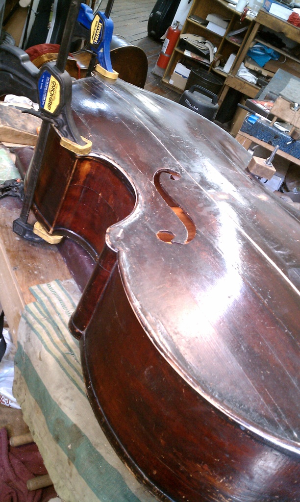

Looks very Neuner'ish in style and with lower rounded corners (as Elgar calls them correctly). Just a rough attribution. It could be just about any maker in the period. I can't say much more form those few pics. Is that varnish original?
Have you seen a Tarr that looked like my bass with outer linings like that. I think they measure 1 centimeter (in metric) where they are un-altered if that helps and not 3/8" (made in inches) as previously listed after measuring and examining the linings again last night. I have heard from more than one source that some Tarr's were made in Germany in one way or another. W.Tarr did 206 basses as did Prescott on record. Arnold is up to about 24 on the bench I think. Maybe they didn't have labor laws then, you think? Or Golf vacations come to think of it..

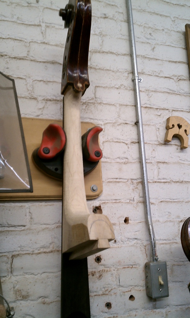

I just got my bass back that I said was identical to the bass in the first post here labeled Wilhelm Uebel.
On my bass, in writing under the Tailpiece (on it) says, "V. Venegas, Uebel".
The repair work is beyond my dreams. Beautiful work and the former LONG 3/4 is now proportionate to it's size at about 41.5" length. The new neck, block cut and deeper neck set allowed this. Plus, a huge discovery I missed. This is the ex-Victor Venegas bass! Mike MaGee that did the work on it worked at Kolstein's a long time ago and remembers this exact bass coming in with Victor several times over the years.
Mike told me that when a bass came if for a restoration Barrie would write under the TP who's bass it was and in this case, what bass it was as well. Maybe because Victor owned several basses I assume.
Also, personally this means a lot to me. Victor was a good friend of mine and a mentor. We even did set-up work together on basses of his students and friends. He would being them to my house, assist me with the work (I did most of the important stuff, lol) and deliver the bass back and collect the money. He also straightened me out with my Bow hold per-John Schaefer (NY Phil) and got me to go back and study again which changed my life. Schaefer would not take any more students at that time so I studied with his top student Bill Blossom, now in the NY Phil. for about 35 years or so.
So, this bass being Victor's old gigging bass means a lot to me. I know he had two others but this looks like it was his work horse for a period of time.
