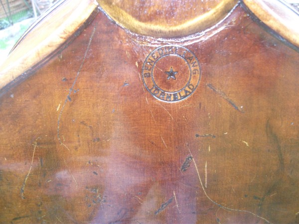

I just saw an old 5er made by Benedikt Lang I, who worked in the Schonbach area c.1920. This is not B.Lang II from Mittenwald but might be related. It looks typical turn of the century German/Czech and was made originally as a 5-string. Not quite 1840-50 but old enough to be settled by now.
