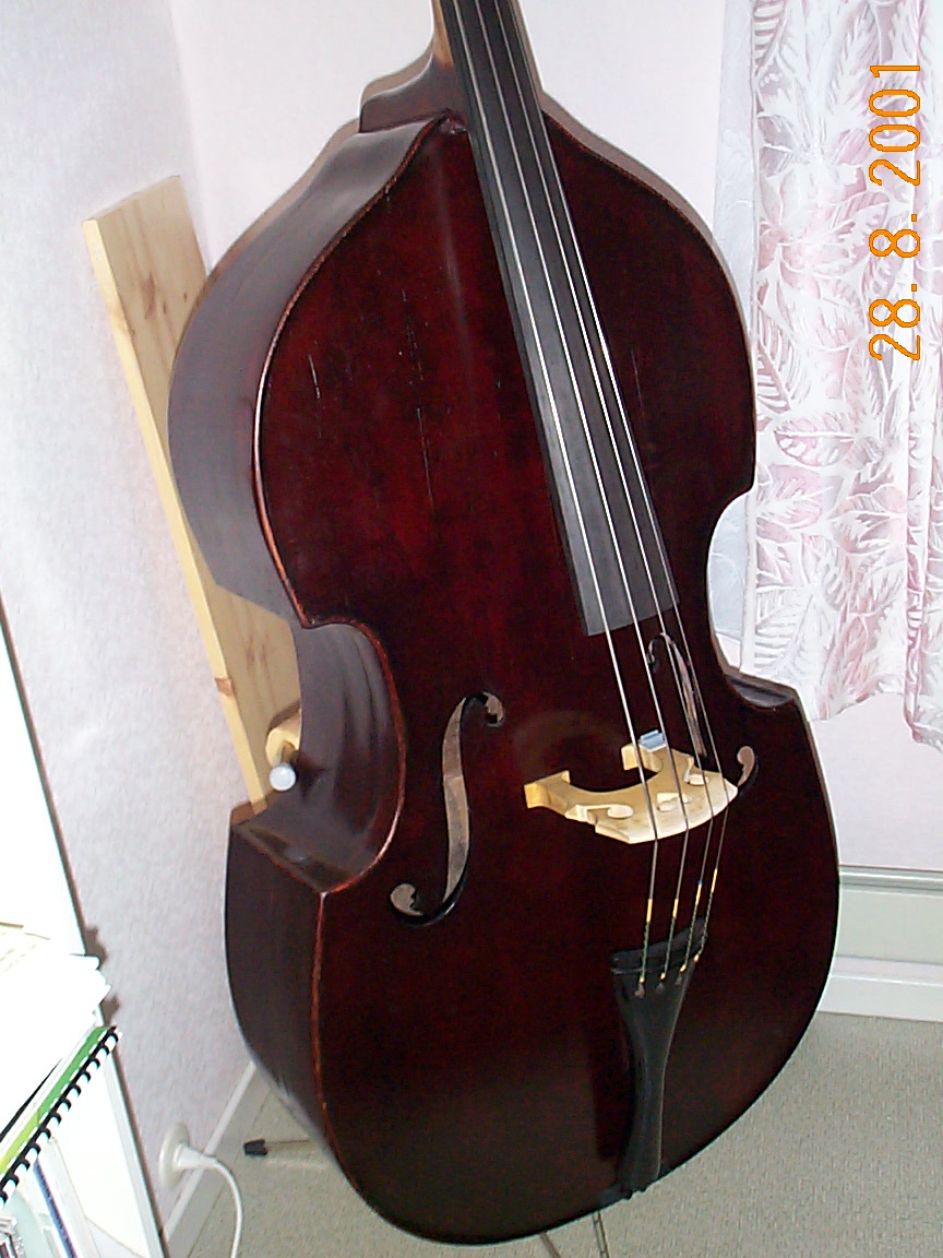

Hi, are you familiar with Bohuslav Lantner basses? I have a 1883 flatback bass labeled Bohuslav Lantner Prague. It is a converted 3 stringer and the neck has a wedge in it. I like it very much. Smallish 3/4 gamba size with a distinct sound which projects good. Here is a picture, not very good though.

Old 06-12-2012, 11:46 PM
Question Blockless..
Blockless German/Tirol/Tyrol/Bohemian Basses from the early 1800s thru the early 1900s, WHO knows for sure where these were made and by whom if anyone can name a single maker or Shop? There seems to be nothing written anywhere that points to anything concrete about these basses other than basic assumptions and folklore. Is this some kind of German, Austrian, Bohemian or Bavarian secret?
