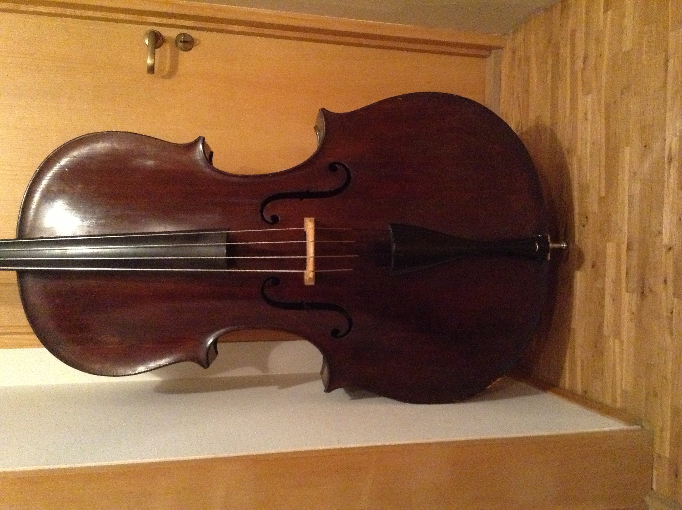

This is my Prescott bass,dated 1826 with the number 70 also on the label,which matches a Prescotts's listing of a double bass made in jan.1826 and sold in April 1826 to someone named Woodman for $62 including(B,B,C) brass mechanism,bow and case,most likely.

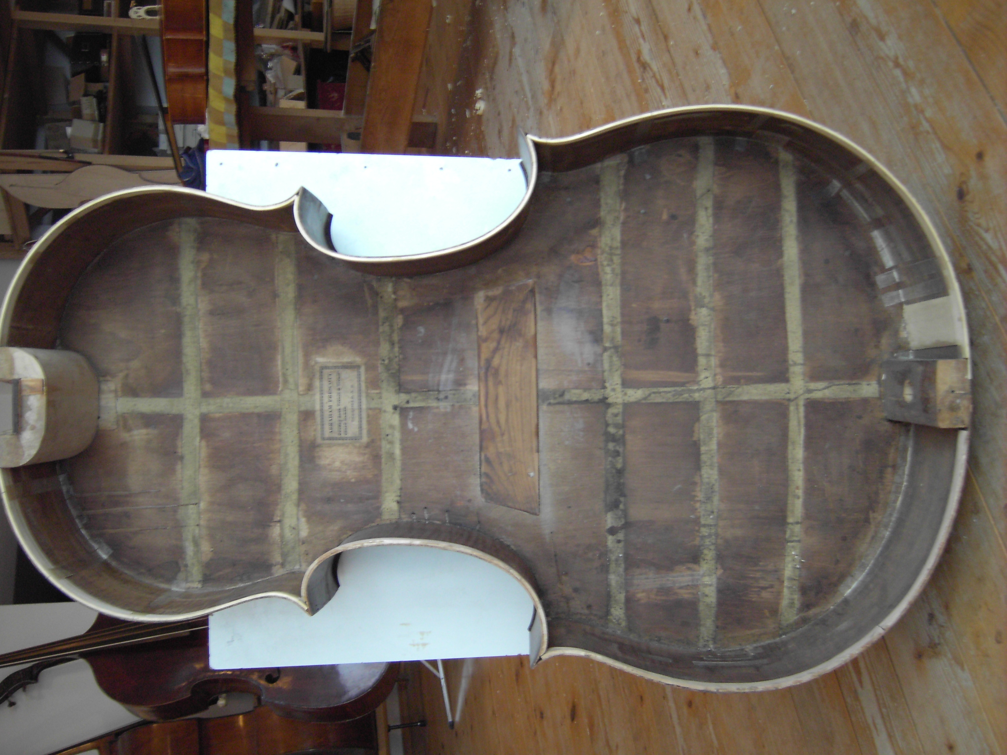

Here is a photo during restoration,of interest is Prescott's use of a back brace on a round back bass . Original bottom block and new linings for the top to make layer repairs easier.
The Top block is new and this was possible a blockless bass at the neck originally. The cross strips look like later work as well. The small center post bar looks similar to what is in my Panormo school bass as well as my Malvolti. We do not know if either of them are original but they are very old. I prefer the 3/4 cross post bar in roundback basses and have had them added to many of my older basses when in restoration. Also, some new basses I commissioned I had them in as well. Thanks for the pics.

Lightbulb
Wow, I just noticed, No corner blocks either. Interesting.

I believe the long strip and 6 cross strips are original as they all very similar and the Prescott label is on top if it. The neck block is new but you can see where the original block or bottom of the neck was. I would think that there wasn't a real block but rather like a guitar with the sides slotted into the neck root.the top and sides were definitely built that way like the church basses. Do you know of any other dated and numbered Prescotts?
I have seen some Prescott pictures of the tuner plates with a date and or number stamped in. I think with most of them being converted to 4-string with non-original gears, some of those dates or numbers we lost as well. Labels also disappear during repairs sometimes.

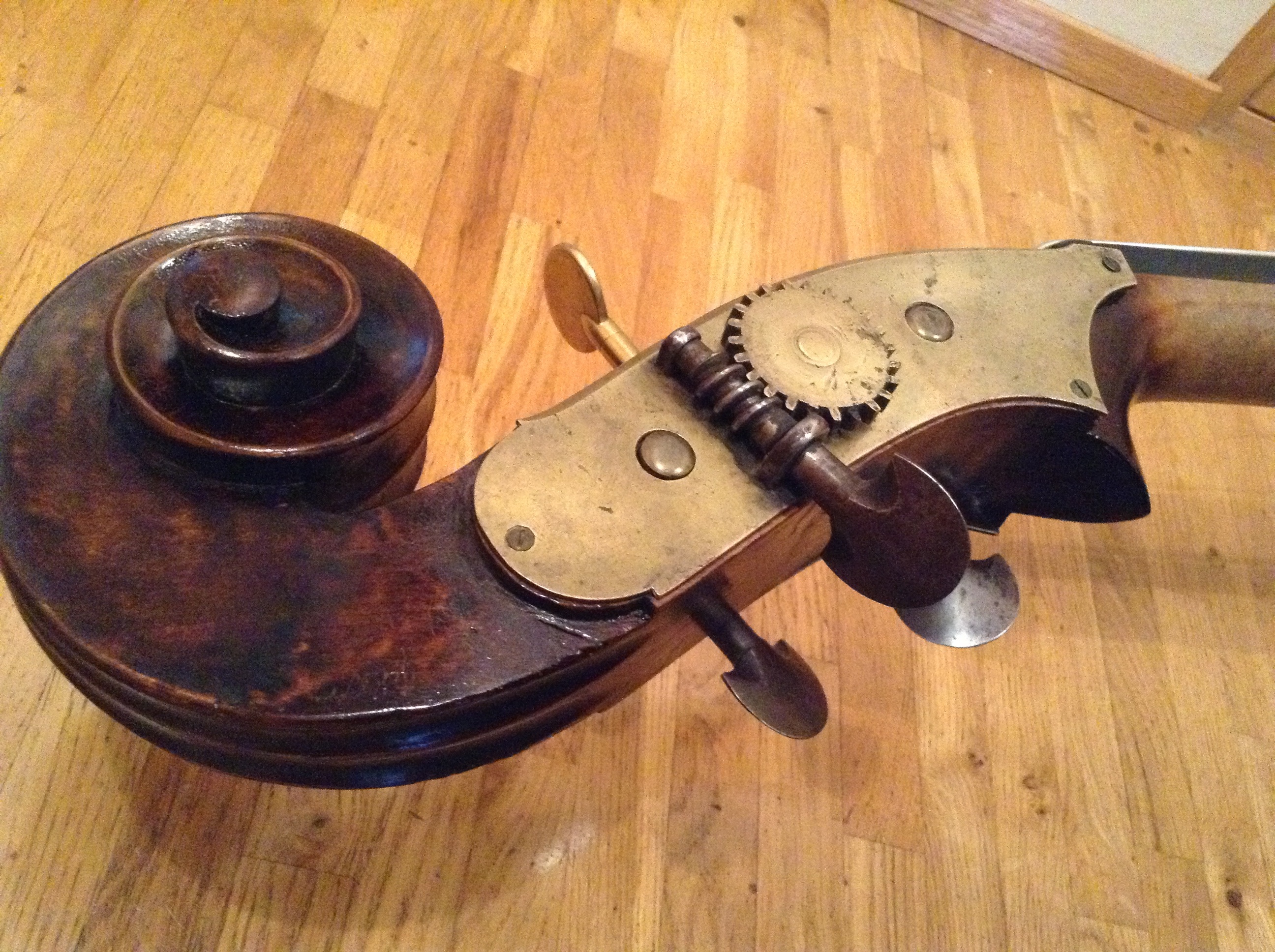

Beautiful mid-evil type axe handle gears.
Can we see the other side or the peg-box/gears?

Posts: 14
Richard Korn is on a distinguished road
Mid evil type axe handle....lol..My first thought was early American so maybe Indian arrow head influence!

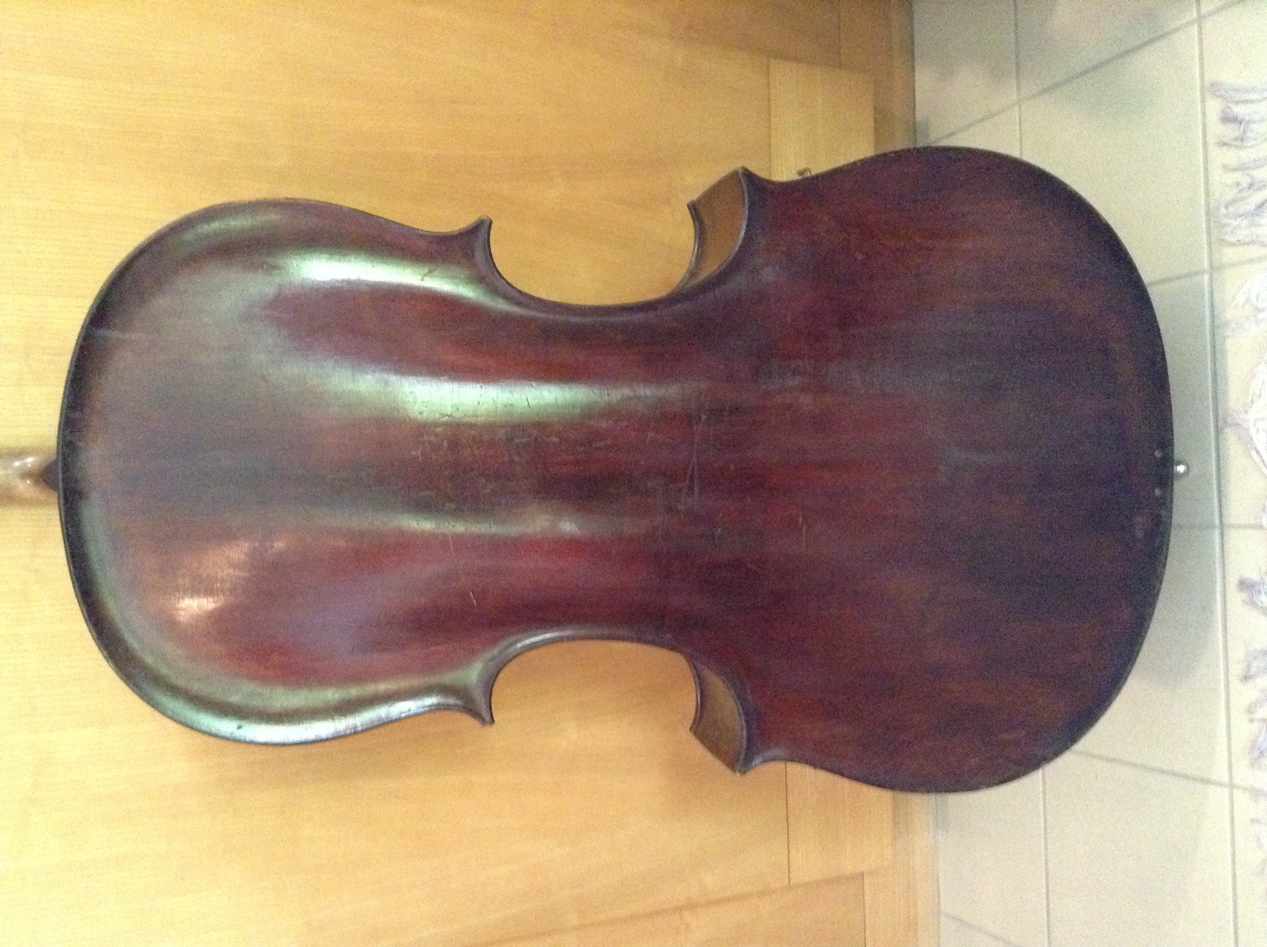

Adam,
here is picture of the back. Post # 2 above shows the inside of the back and you see it is a round back bass so no braces, just the one for the sound post to sit on. This is the earliest model of Prescott basses, almost identical to the early church bass and probably only made in Deerfield til ca. early 1830's, the more typical bass with busetto corners is a later model.

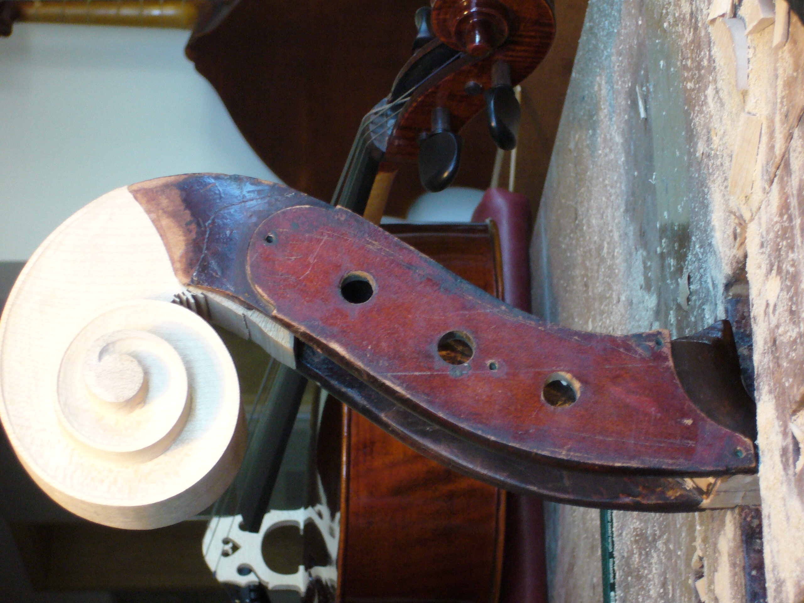

Here is my scroll getting a new volute which had been broken off and lost.what was on there when I got it didn't look right at all so I had a new one made with photos and measurements from the bass in the Museum of Fine Arts in Boston.
Can't seem to upload 2 pictures at once!

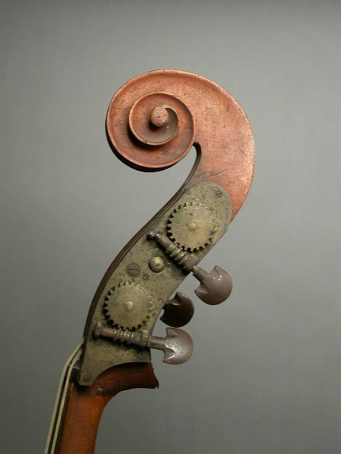

Prescott scroll from the MFA bass

The whole head was lost before?
Old 07-17-2013, 11:09 AM
Richard Korn Richard Korn is offline
Join Date: 07-06-2013
Location: Reykjavík, Iceland
Posts: 14
No, the volute was missing at some point and when the bass was set up,it got a new one which didn't fit and a new neck,which was really to short to use properly, so I had both replaced.
Old 07-17-2013, 11:13 AM
Question ??
Your picture shows an entirely new head being made from what I can see. Everything new from the top of the pegbox, correct? That is what I mean by 'Head', the top part.
