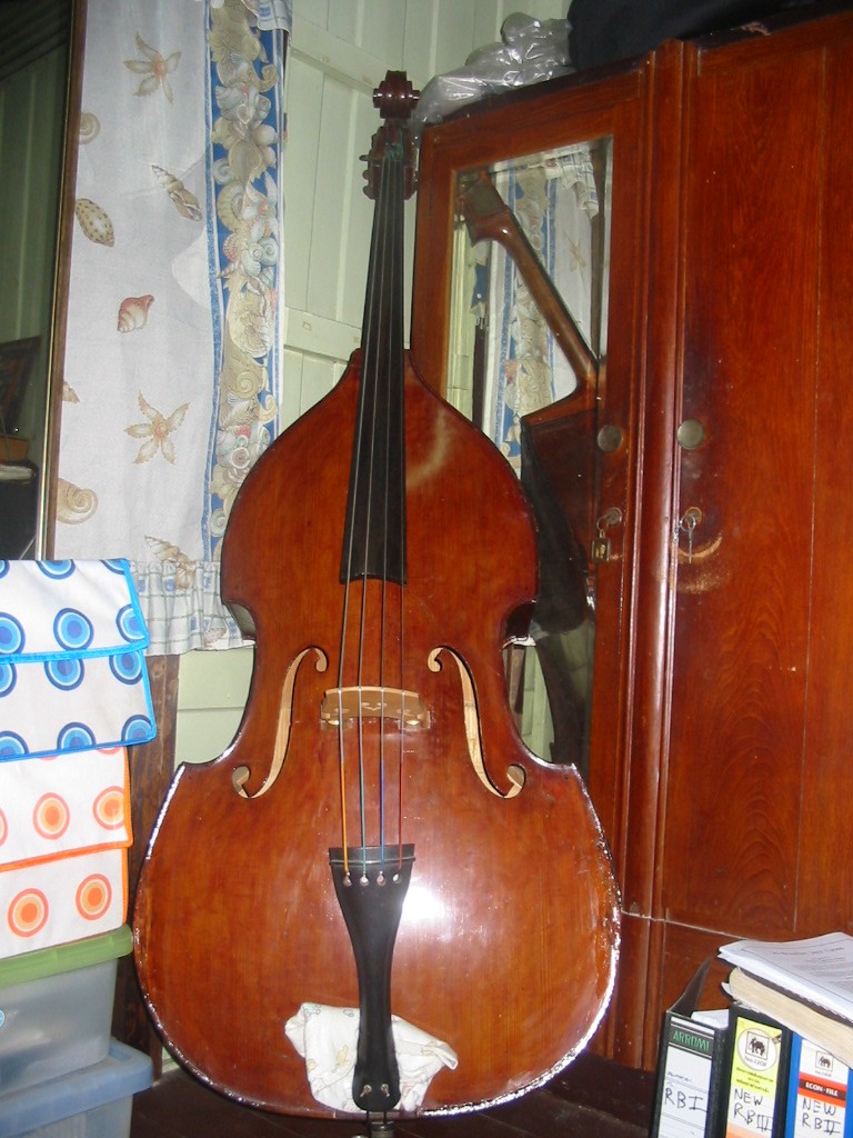

For example, if a client told me he/she wanted a strong upper register and moderate bottom, I would increase the arch height and keep the top a bit thicker. The opposite for a bottomy, thumpy sound...
That why my bass has a very strong upper and moderate bottom. Also, My baby is so heavy.
PS. I don't know the original of my bass.

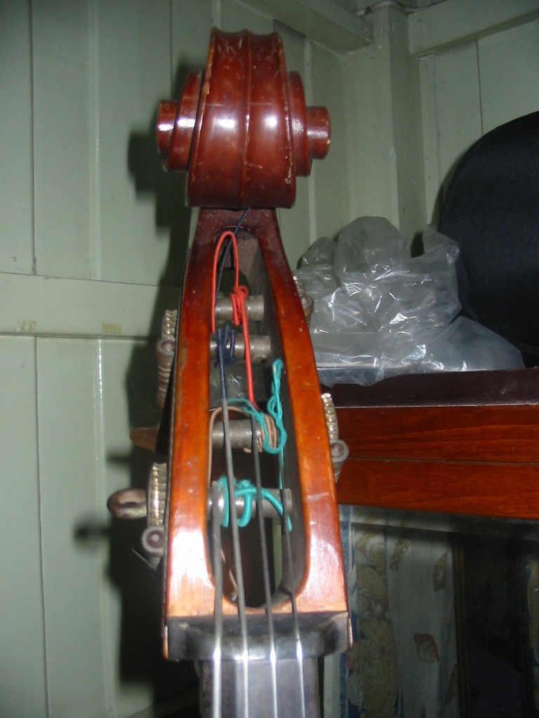

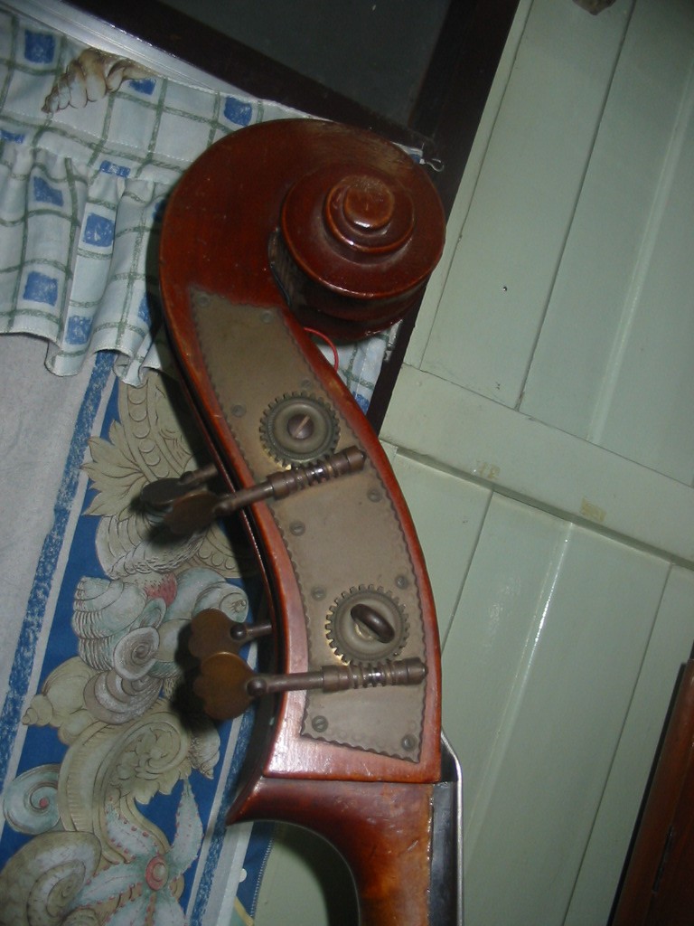

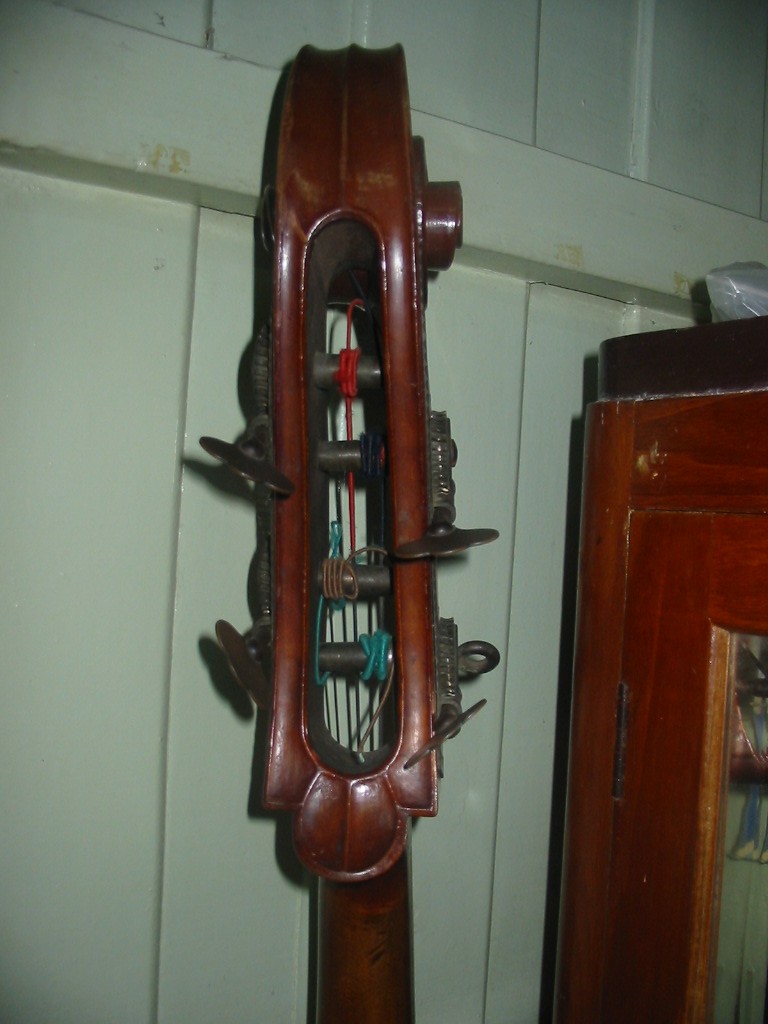

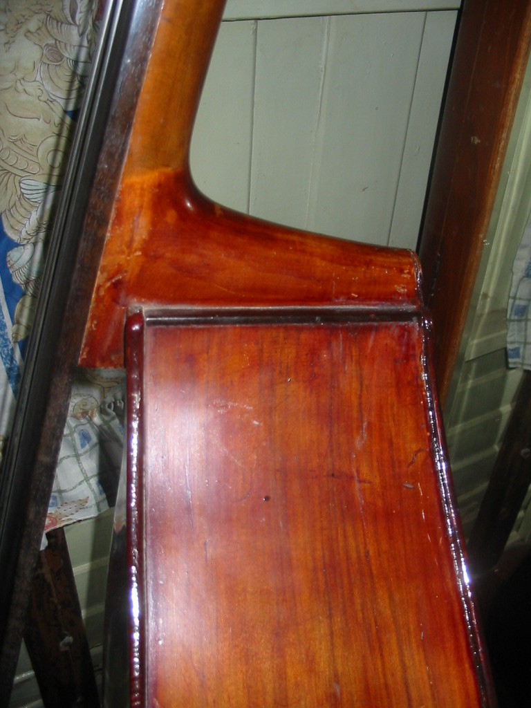

I would like to see the rear and sides of the pegbox/scroll and the sides vies/profile of the Ribs as well. It looks like a 1920s - 1930s French Bass to me. This style has seen labels like Bisch, Collin-Mezin, Quenoil and a few others.

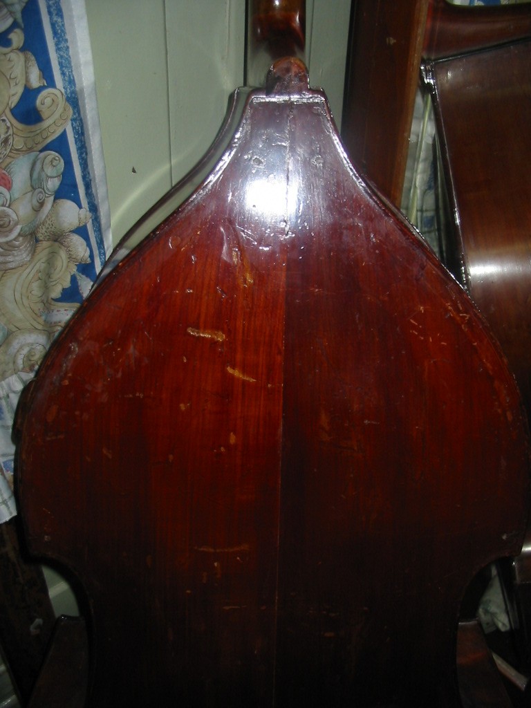

[quote=Pongsak Sooksawak;4073]That why my bass has a very strong upper and moderate bottom. Also, My baby is so heavy.
Plus, the shape of your bass prevents it from being deep-sounding. Generally, basses with small, sloping shoulders (regardless of the lower bout size) have a penetrating sound, but little in the way of bottom.
Here, I took those pics since I got this baby.

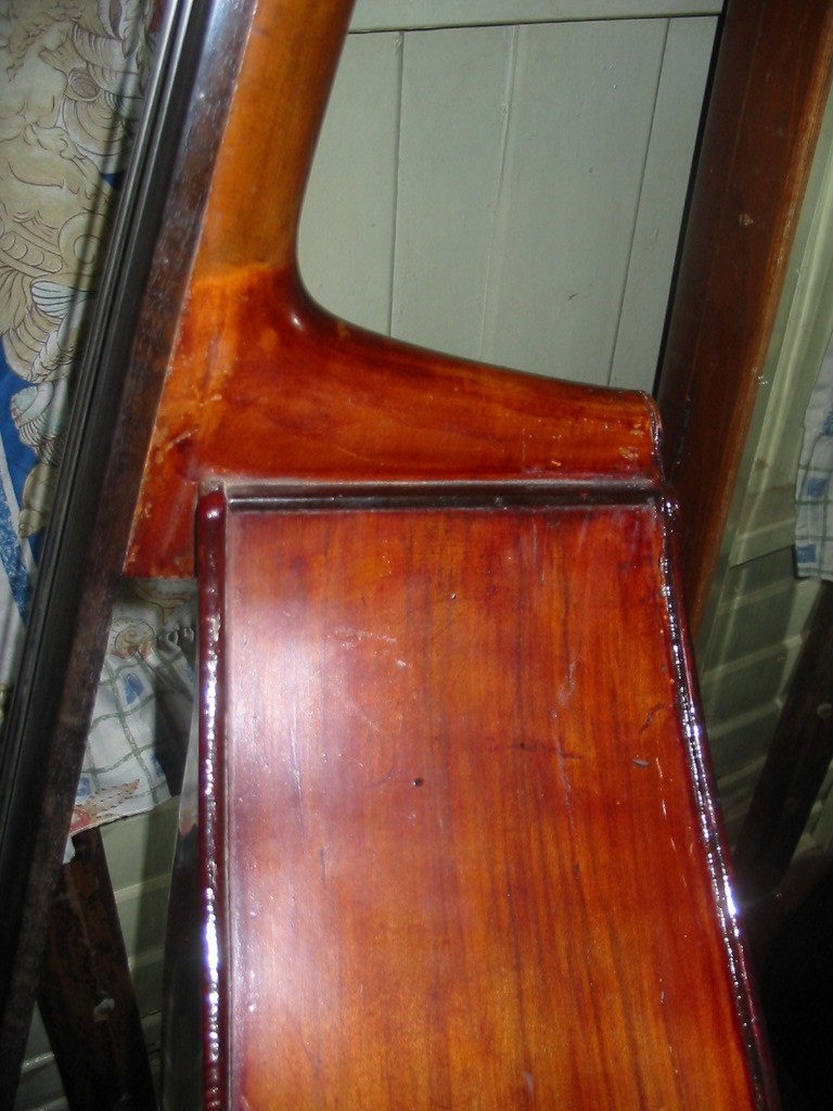

And, my bass has some kind of nail made from ebony wood in the corners (near f hole), like all basses imported to this regian (south east asia). For example, my friend's Hawks has the same thing.
Ps. It located in Bangkok, Thailand.
Ebony nail near the F holes? Can you show me a picture of that? This sounds confusing!

That is very difficult to capture the pic. But, that's not the nail. The position is not near the F holes.
Here, that's the same thing happened with the Hawkes and Son Concert Double Bass labelled and dated 1910 - #2644 from the contrabass shoppe, UK.
"The instrument has what we call “pins” - in the corners and at both top and bottom blocks. These were fitted to instruments - that were destined for use in tropical countries. In glue-softening high humidity's - the pins would help maintain the position of the table and back onto the blocks."

Pins are usually drilled for BEFORE the Top comes off for Repair so it can be fitted later in the proper place in case the Ribs twist out or shape. I don't know of any maker/company that would make a Bass with the pins to start with. With the Hawkes Basses being made mainly in Germany with some in France or England or finished in England, I don't' know how they could predict the buyer location that far in advance of them receiving the Basses from the Shop making them to plan the 'Pins' as you seem to believe were pre-meditated.
My Loveri has Pins in all the Corners and Neck area as well as the Scroll which I believe are decorations to make the needed ones in the Corners look matching.
Yes, exactly like mine.
Thank you for your information.
