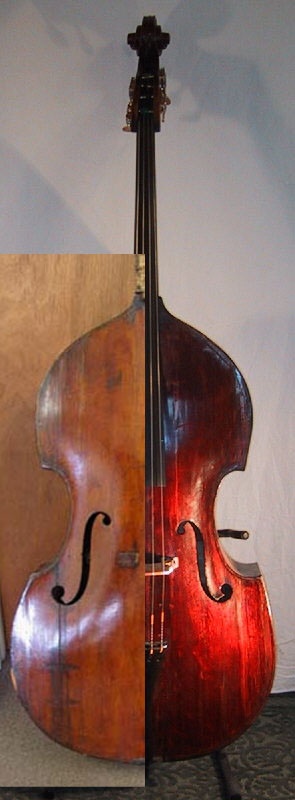

I got this Bass back in Feb, 2004. It has many flavors from all that have touched it. In March of '04 it went out for a full restoration and reconstruction. I am expecting it some time this year (2007)

The total height of the actual Bass (without endpin) is 77" tall (6ft.5in.). It was probably an 'Eb' Neck and will be reduced to a 'D' Neck ending up around 76" or so after the new Neck graft.

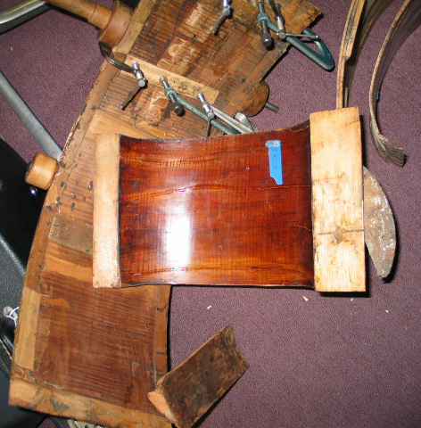

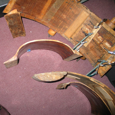

Here are the pics of the Cheeks I made 3 years ago. The Cheeks will get thinned down slightly before the Varnish touch-up.

Previous update When the Mystery Bass was first opened in Jan. '05 Paul called me at my Shop. When I said hello to Paul on the phone that very day, I heard some screams like Tarzan was having a bad day.. I asked "what was that"? He replied "your Bass, I just opened it up". He mentioned he was thinking for weeks which way to attack this Bass as the Ribs have to be fixed first along with either the top or back so the other plate can come off and have something to go back to.
Now for the discovery, The Bass currently has an 'X' Brace which we know was a 19th century repair in Mass or New Hampshire. We also know there is a set of scars from earlier cross bars that were the original, so we thought... BUT........ There is a "third" set of scars from even earlier Bars in this Bass that is quite unusual. Mainly the Bottom, widest point (originally about 29" wide) had a pair of thin TWIN Bars running across the Bass. This he said is OLDE English as in English Gambas.... The English made Gambas as far back as the 16th century. This Bass however is most likely no earlier that the mid 18th century as far as we can see for now..

Well, I don't know. The shape of the upper and lower bouts look completely different to me. Somehow the shape of your mystery bass reminded me of that Houska article on the Prokap bass. http://www.contrabass.co.uk/spring98.htm I know you don't think it is related to the Prokap bass, but something about the way the c bouts flow into the lower bouts seem more similar than this bass. I get a Bohemian vibe anyway.

I do see what you mean about all the different influences.
I'm not so experienced w/ 'f' hole ID, but to me the upper bout shape definitely has a French feel to it. Almost "Lamy"-like http://www.contrabass.co.uk/2453.htm , although we know that this bass is earlier. How about these English guys?; http://www.contrabass.co.uk/2114.htm , http://www.contrabass.co.uk/1900.htm , http://www.contrabass.co.uk/2657.htm ,or these German guys?;

Just looking at photos and not considering the other clues that point to England, the f holes are the most similar characteristic to the G. Corsby DB. The arching also looks similar. The outline just doesn't seem the same at all. The bouts are almost taken from a perfect circle on the mystery bass. The Corsby is much more anglular in the bouts. But shape alone doesn't necessarily mean that much. Weren't the shoulders of the mystery bass altered as well?
The Prokop bass certainly has a lot of the same general shape characteristics, but the other details of making don't really match at all. The shape is definitely heading the same way, but the mystery bass has bouts that are much closer to the same size. Also, I would reason that it makes sense that outlines might be copied more frequently than construction methodology. So you see borrowed forms "by the English hand" so to speak. In any case, it has one of the most pleasing outlines that I think I have ever seen. I guess there are only a few makers that could have plausibly made that bass given the factual evidence of it's origins, the wood type, etc. So it is at least narrowed to an English maker. If not Corsby, then who? That becomes the question. So we look at the f-holes again.....

Well, yes. I think it's closer to that Joseph Hill bass than the Corsby. Are the F's that different? Imagine this Hill Bass w/ more rounded upper bouts..pretty close.
From the pics the back has an almost Pearwood look to it. Is it deffinately Sycamore? If so where else could there be fine Sycamore during that period?
It's shape deffinately doesn't point one way or another too clearly.
Is there anything else that points to some other early European school like Dutch or Scandinavian, Vienese? or does it only seem English or Germanic now?
Sounds like you'd need to explore that viol/gamba or bass violone transitional period a bit more, but I wouldn't leave out that same period in France either. I don't know now, the more I look at the your bass the more it's outline feels French to me.
W/ it's large dimensions and internal bracketing issues could it only be a true double bass or may it have actually been a modified later Bass Viola Da Gamba or "Bass Violone" of some type?

I agree it looks french to me
OK the ffs don't match ... but the outline is close
7/8 french 1800

Question French?
While it does have some French flavoring it also has a lot of English on the interior not to mention the wood itself being English Sycamore on the Back and Ribs. Biase thinks it could be a French 'influenced' maker or even a Frenchman itself working in London.
Arnold, for education purposes mainly, please tell us how you will inspect this Bass inside and out to take another guess at its origin once the restoration is complete. This would be your first time seeing this Bass in person unless you have the chance to see it at Biase's shop before he has it all together.
What are the points you look at both directly and indirectly as well as overall?
Old 07-31-2007, 10:53 AM
Cool outline...
7/8 french 1800
Matthew, I would also look at the edges, arching, upper and lower corners as well as the FFs. I have yet to see a French Bass with FFs like on mine. I agree the upper bout is close but only slightly in outline. In fact, they both look sort of Germanic which was a style both the English and French worked on as far as the Gamba model Basses.
Old 08-06-2007, 06:23 PM
Arrow About the French...
I agree that the Bass looks just about as French as it does English. I was reading now that one maker (Barbe Pere') gradually tapered the upper bout to the Neck without any angle bend. I have heard this trait before about the French. I am not 100% sure though that the Bend is original. Or is it?
If this is a French instrument (Bass or Violone), then who were the makers c.1800 (+/- 25 years est.) that might have made large Gambas like this? I wish I had as many books on French makers as I do of the English. Probably very few were written and even less written in English!
So, broadening the search to include France adds more possibilities. Now it seems that instead of looking for a Frenchman or French influenced maker working in England we are also be looking for a Frenchman with some use of the half-Purfled style (English Ink Back/Purfled Top) that 18th Century London had occasionally produced.
