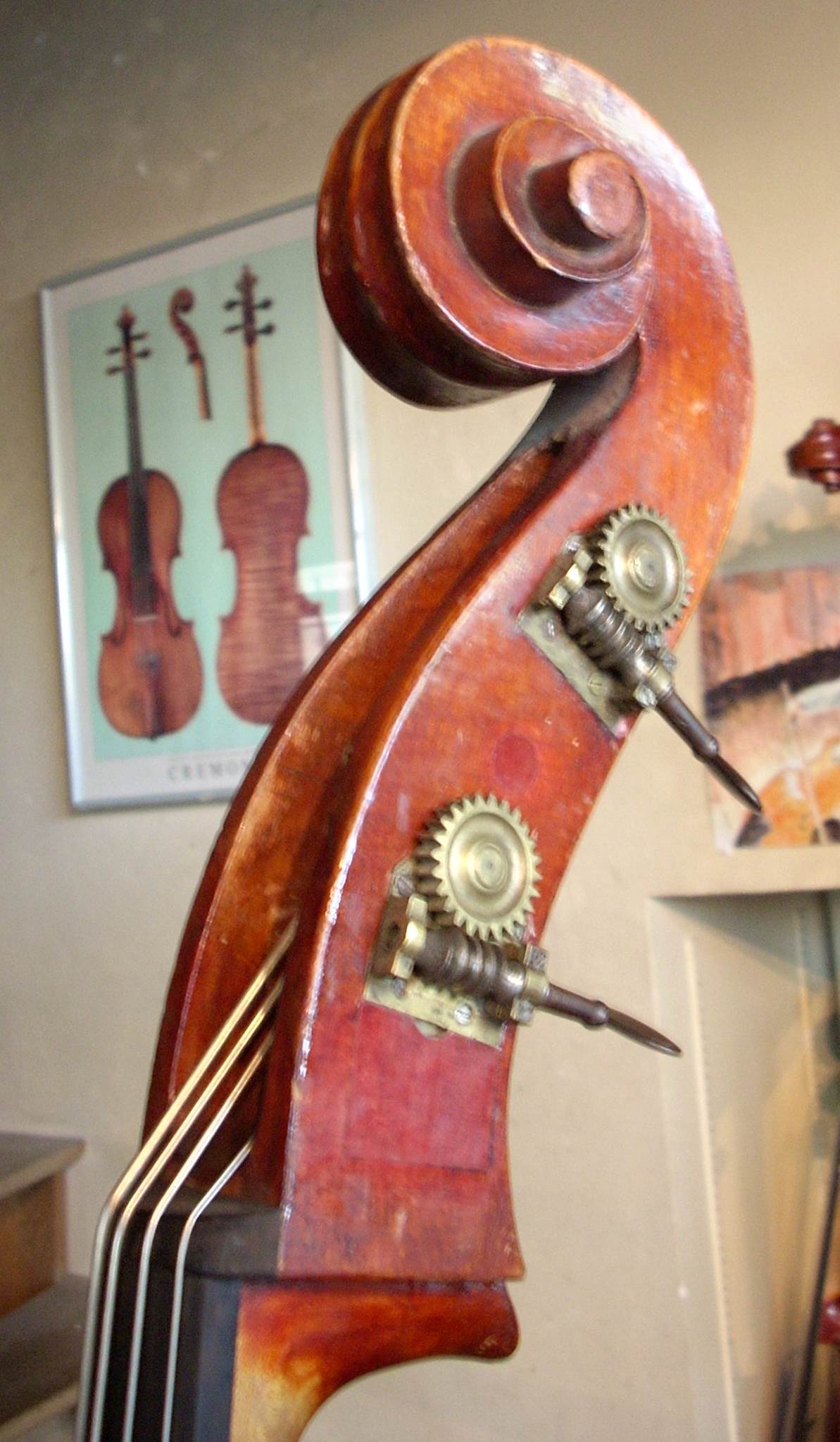

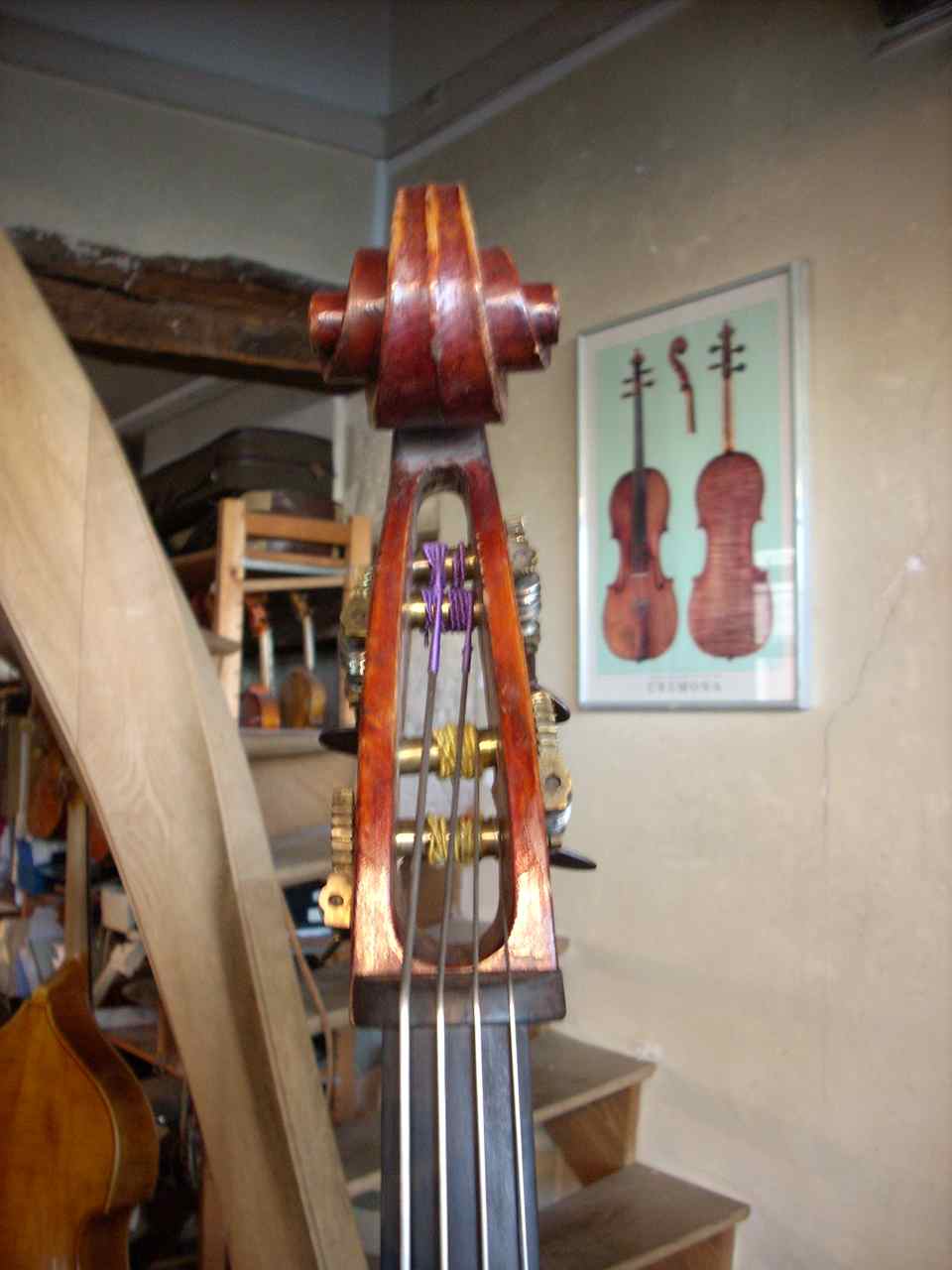

Old 01-28-2008, 07:19 AM
very interesting topic,
i once have seen a bass that was strung this way (see picture). now i begin to understand why
Old 01-28-2008, 07:43 AM
Cool maybe..?
Originally Posted by Michael Harrison Jr. View Post
Will unwinding the E & A at the same time reduce enough pressure to let the soundpost fall, or should it be ok? I'd like to test this on my bass.
Lie the Bass down carefully and loosen the D and G slightly as well so the Bridge doesn't try lifting. The Post is held more by the G and D than the A and E but be careful of bridge movement while doing this. In the winter, the Post is usually tighter.
Old 01-28-2008, 07:47 AM
Cool wow..
Now that's drastic. The thickest string the highest and the thinnest the lowest. Looks like some re-learning is in order here as far as tuning goes. Still, I turn the wrong peg on occasion as not all of my 'E' are up high, just most of them. Also, I spent my whole life with the E being the lowest so even if all the Basses are strung the same, in a pinch I grab the wrong tuner.

Old 01-29-2008, 02:05 AM
A pro player here who is also a luthier was working in Paris a few months back and visited a shop where he found all the basses even the cheap ones sounded and played so well
i took the photo in paris, maybe it´s the same shop?
(but the bass in the pic didn´t sound that good to me)
Old 01-29-2008, 03:07 AM
He tried it when he got home and swears his bass sounds and plays better than it ever has. Haven't tried it myself - anyone else?
Has he also tried a compensating tailpiece? If on that bass it works at one end of the string, its probably going to work extending the afterlength at the other end ... and maybe easier to install and get used to tuning ...
Anselme, that's an interesting pegbox with its open back - don't see them very often. Also the spacing of the machines in two "pairs". Do you remember what bass that was? I've only see machines installed like that by another local maker.
Old 01-29-2008, 03:14 AM
it was a vuillaume st. cecile. (at least that´s what the luthier said...)
i have some more pics if you´re interested

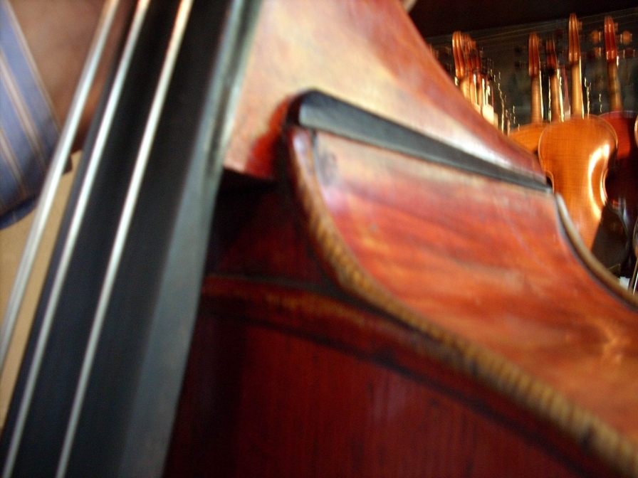

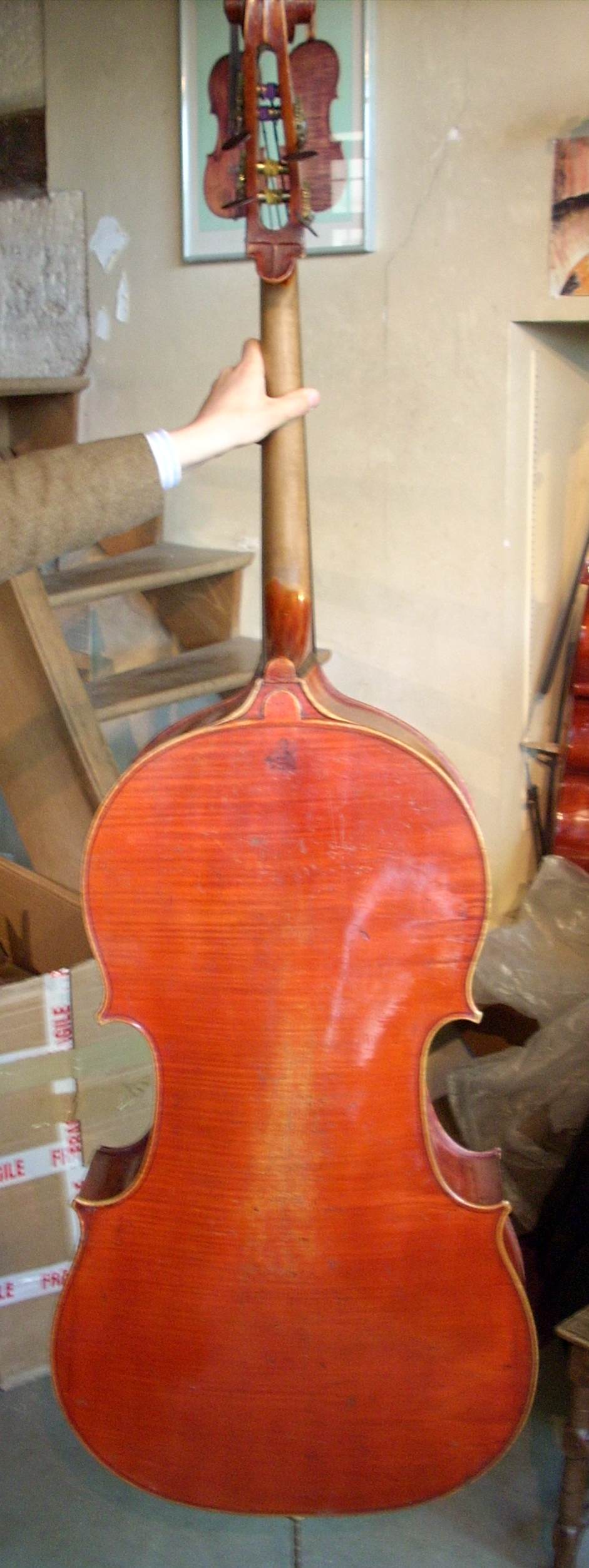

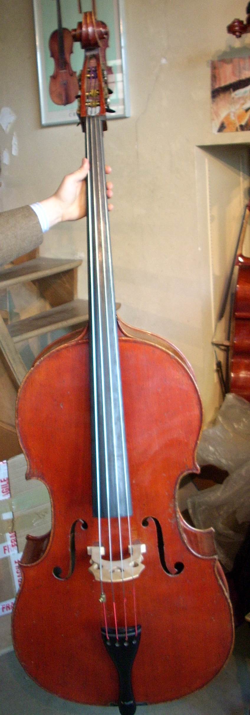

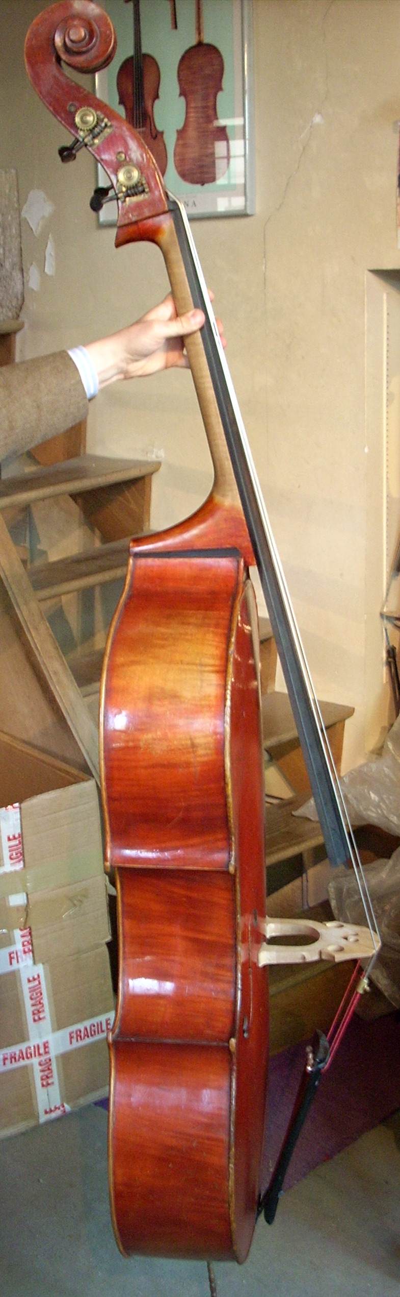

ok matthew, here we go.
iirc the bass had on original string lenth of 98cm (38,5")
the luthier changed the neck, now it has 108cm (42,5")
i will not comment this, if you have your own opinion what a well proportioned bass is, well...
the sound was a little to harsh and bright for my taste.
i´m not sure if its a real vuillaume. although the st. ceciles were a kind of economyclass-instruments, this one seems to be too less accurate made, imho.
i am courious what ken (and arnold?) will say.

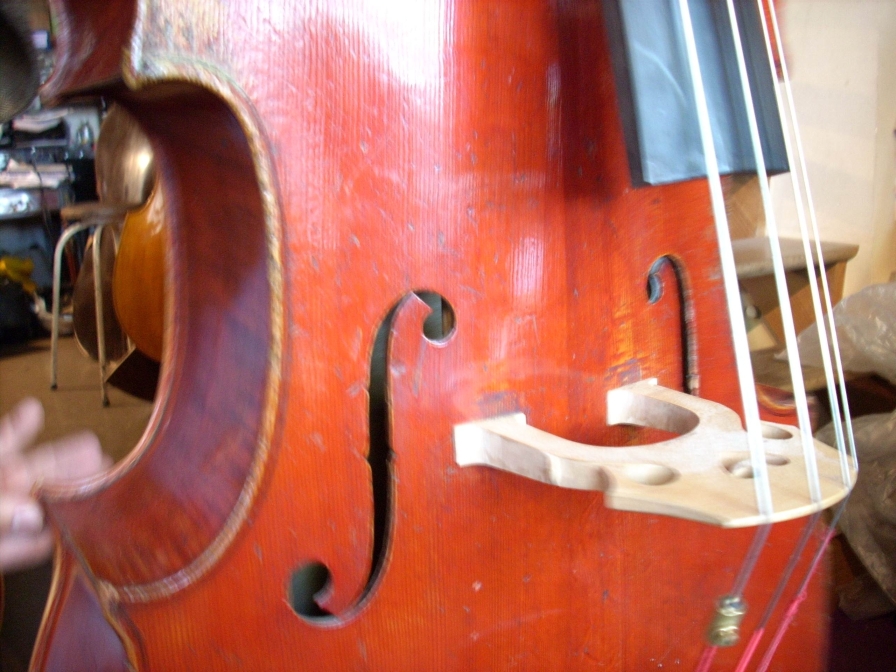

Old 01-29-2008, 01:42 PM
three more pics

Old 01-30-2008, 11:19 PM
Thanks for posting those Anselme
That is one peculiar looking bass, particularly around the neck region. Kinda looks like a regular bass with a "cello" style top stuck onto it. Is all that carving (double button etc) all part of the design, or is it a result of a reconstruction somehow?
From the side, the neck heel looks rather weird ... how to be sure where your D stop is with such a wide heel curvature!
looking again at those machines, they can't be original? sure looks to me like the whole pegbox has been reworked in an "individual" way.
mt
Old 01-30-2008, 11:44 PM
Cool Is all that carving (double button etc)??
mt
Matt, you need to get out more. That is THE typical 19th century French Bass, Violincello model. It may have originated as a design by Vuillaume but I see it on just about every French makers Violin cornered Bass from about 1850-1900.
