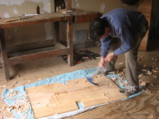

If anyone is interested, I will post some photos of my "project"......Thats me in the picture chipping away.

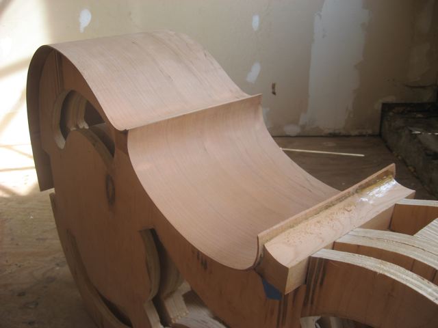

Here is the Rib structure without front and back plates. I just completed the mortise for the neck joint (notice the saw).

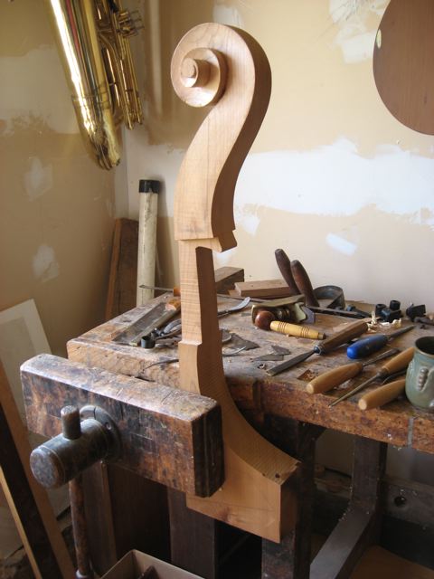

Here is the neck and the half carved scroll, the volutes still need to be carved in.

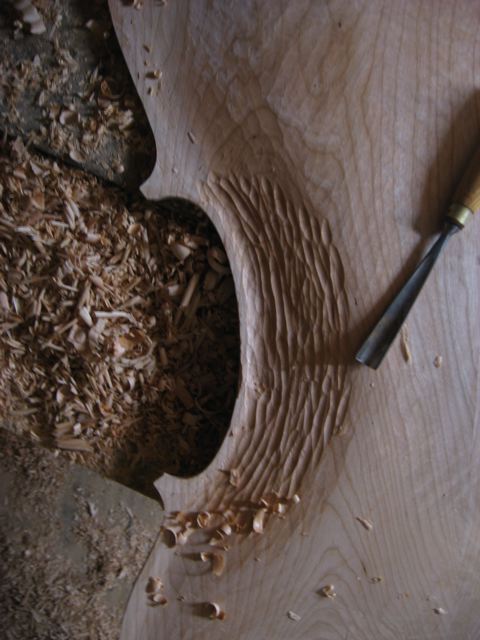

Old 09-20-2008, 08:21 AM
Join Date: 06-29-2008
Location: Pompey NY
Posts: 110
Chunking out the opening for the strings and machines.

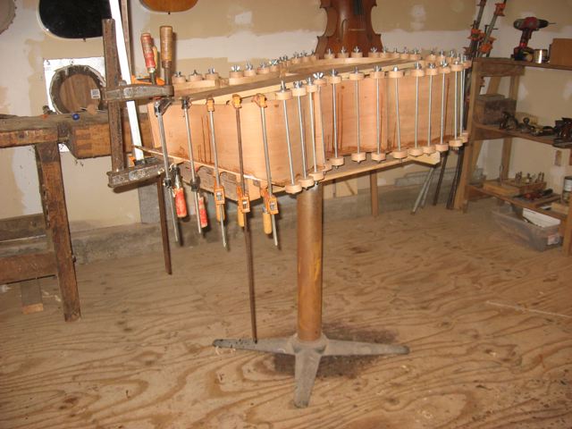

Old 09-25-2008, 09:22 AM
Location: Pompey NY
Posts: 110
Default Glue up 9/24/08

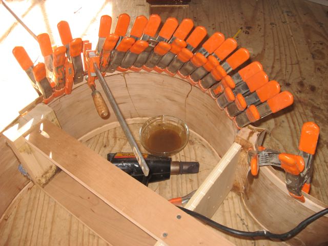

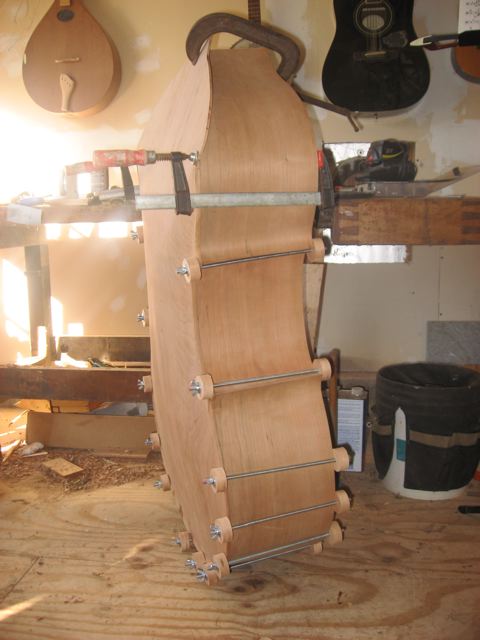

The back is now attached to the ribs! It was a very difficult operation and I am glad its over. Here is some highlights of the glue up procedure:
I made a special glue up bench from an old restaurant table. This new bass holder allowed me easy access to the bass carcass during the glue up (saw horses would have been way too cumbersome for this stage).
Had to make 44 spool clamps which took up most of the weekend.
The back has a 25 degree bend, so it needed special cauls to keep the clamps from slipping.
It took about 20 hrs of preparation and staging for a 15 minute glue up.
Now it is time to clean up the glue, and start planning the top.

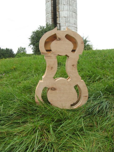

This is how the ribs came to be:
10/07 - Mould for Panormo Bass.
10/07 - First Rib.
11/07 - More ribs with corner.
12/07 - the linings.

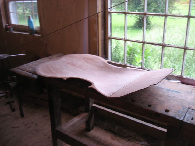

Default The Back; Quick Review 1/08 - 6/08

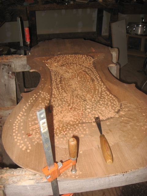

2/08 - Carving the back profile from a Cherry blank.
2/08 - More carving.
3/08 - Outside of back nearing completion.
4/08, 5/08 - wasting away the inside.
6/08 - The bend.
The back took a long time to make.

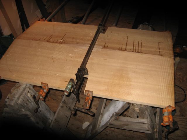

Default Top Plate 8/08

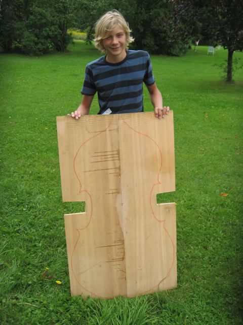

Over the summer I got started on the top plate.
1) Spruce Billets before glue up. This was a big chunk of lumber.
2) Clamping.
3) My helper with our future bass top ready for carving.
ID:	679  Click image for larger version
ID:	680  Click image for larger version

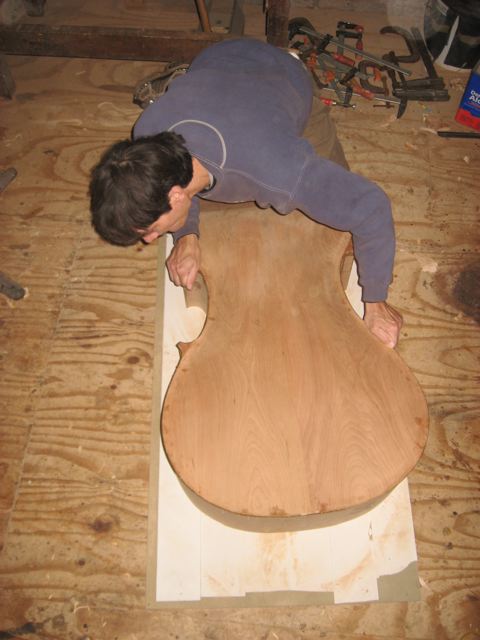

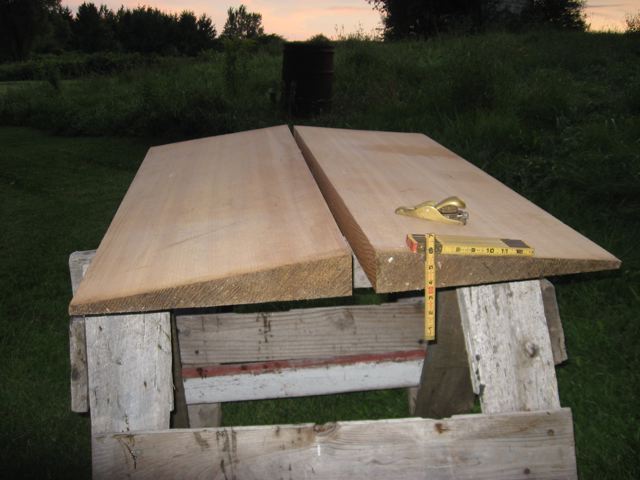

Old 09-29-2008, 09:25 AM
Location: Pompey NY
Posts: 110

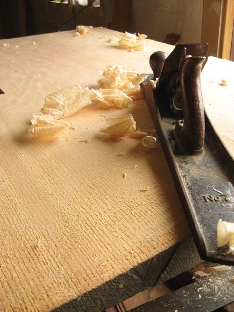

Default 9/08 Top plate
First thing to do was joining a flat side on the blank. Hand tools worked the best since the top is so large and the spruce is easy to work.
Next up: Leveling the front edges of the rib structure and tracing the bass outline to the spruce top.
ID:	682  Click image for larger version

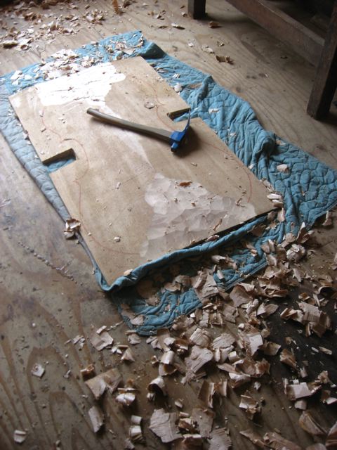

Old 09-30-2008, 09:10 AM
Location: Pompey NY
Posts: 110
Default 9/23/08
Originally Posted by ed hauser View Post
i find the building of these things fascinating so keep up the good work and keep posting the pics!
I am glad you like it Ed, and I appreciate the encouragement.

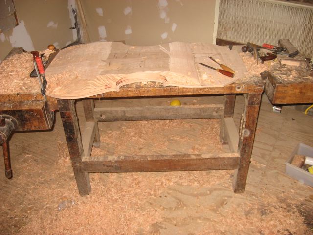

Digital photography is amazing; Thanks to Ken's Corner and the internet, I can snap a picture in my barn and within minutes have it seen world wide. This is what I did yesterday:
No power carvers on hand, so I used an sharp adze to "roughly" reduced the top thickness at the edges. Looks crude, but it worked just fine.
Next up; the jig saw will cut out the shape of the top.
ID:	684  Click image for larger version

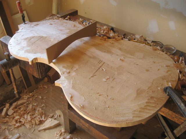

Old 10-01-2008, 06:11 AM
Location: Pompey NY
Posts: 110
just curious, how long does something like this take to build? is this for you or are you producing it for someone else? ive always wanted to do a project like this this but it seems so labor intensive it has to be done with a lot of love!!
Experienced luthiers say it takes around 500 hrs to build a double bass. This is my first bass, so I suspect it will take me longer. The bass will be for my son who plays in a local youth symphony. He is due for a instrument upgrade so he can grow as a young bassist.
My regular job is working in a wood shop, but this project is completely different from anything I have ever built before. Luthier work requires a lot more brain time than say, building a bathroom vanity. Also, as I have learned, wood selection is crucial. It seems you are pushing the material to its limits. Balance act between fragility and strength.
Sorry, no pictures today.

Old 10-07-2008, 03:20 PM
Location: Pompey NY
Posts: 110
Default 9/07/08
I traced the outline of the bass to the top leaving a 3/16" overhang; then I cut out the shape. It was exciting to see the silhouette of the bass appear in the spruce. The next step was making the templates for the plate arching.
Evan though I am a little nervous about the next stage of the bass project; carving the top will be fun. My plan is to take it slow and enjoy the "experience".
Time sharpen some tools.
