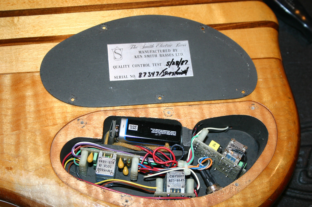

Lightbulb '86 bt5
The 1986 BTs had an Active 2-band concentric bs/tr circuit. No mid, no trim pot. Nothing to adjust other than to have the bass in its best possible condition.
We had also made some passive Basses from 1980 to '86 or so with a passive circuit, no battery in side. We made these in both NY and PA. Most were made in NY. These had one large knob and two small ones and one or two switches. Stand-by at the end and Phase in the middle. Some might be without the phase and some might not have a switch at all. I can't remember all the versions. The Stand-by was great for doublers, putting the Smith down to play the upright bass with out touching any controls and leaving it plugged in, no battery to drain.
Unless I see the Bass in question, I am at a loss to comment further in this particular Bass.

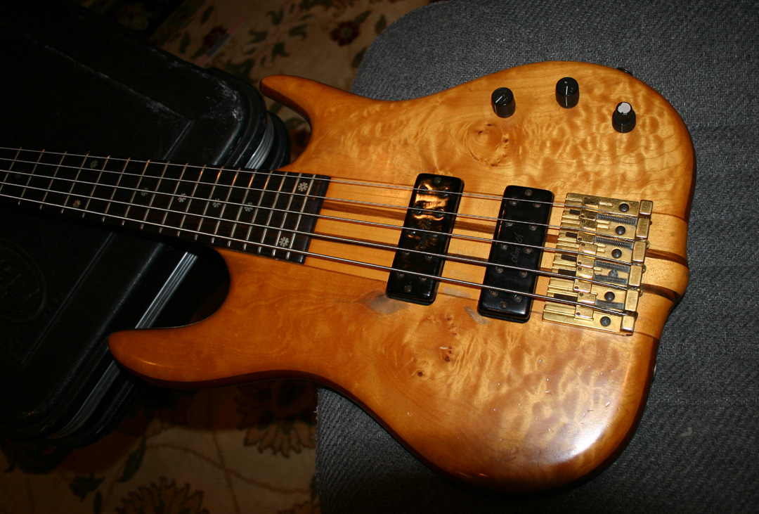

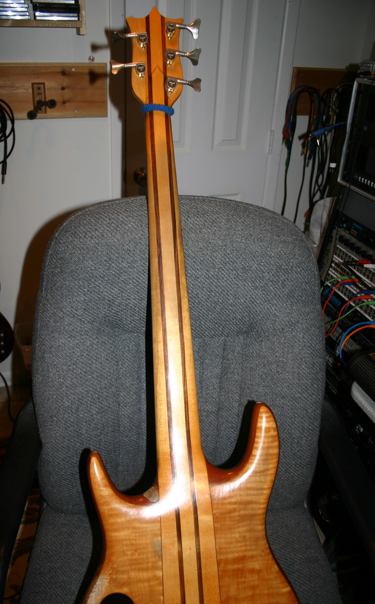

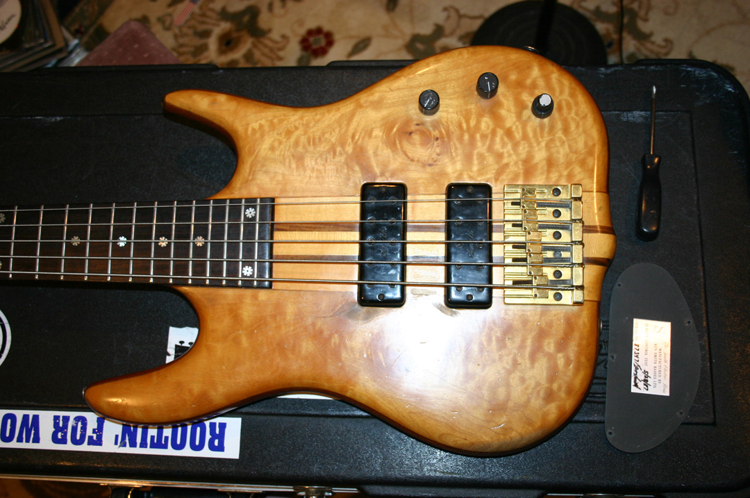

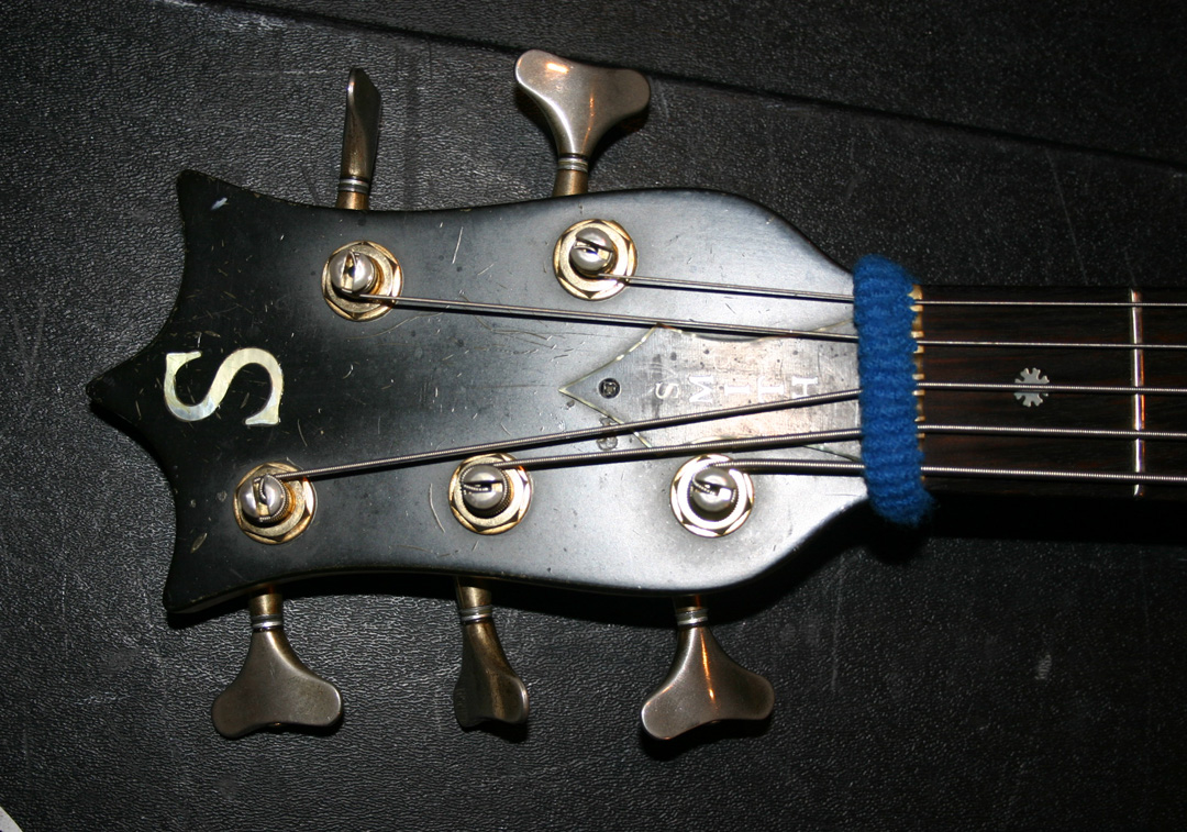

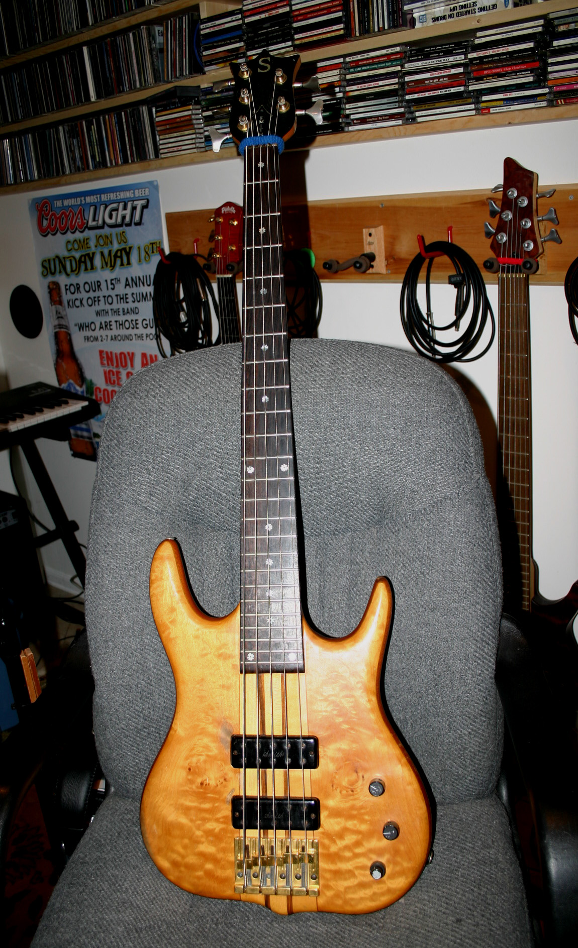

Thanks for the responses, everyone. I should also state that I play with a high 'C' rather the a low 'B'. Like I said, I've got a lot of playing time on this bass. I am enclosing some close-up shots that might help tell my story better.
P.S. It's an'87 BT5, sorry for the mistake.
Thanks again, Jim

Old 12-05-2008, 12:14 PM
Bob Faulkner's Avatar
Posts: 282
Man you weren't kidding when you said that bass has had some miles put on it.. Have you had it since new? There's a lot of blood, sweat, and tears in that finish!

Wink Let it Snow, let it Snow..
Thanks again, Jim
Ahh... The Snow Flake years... I remember them well..
