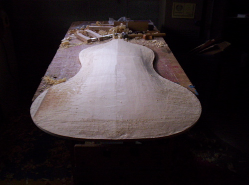

Good to see it taking shape. I can see how you are getting the barrel arch. In fact, I started out trying to get the barrel shape on my bass because that's what the arching looked like in the photos. Then I thought that maybe the barrel was showing as a result of the top collapsing in the centre of the long arch over time. So then I modified it to a continuous long arch.
But the arching pattern on the plans Chandler drew up showed a long flat in the middle of the long arch, slightly higher on the lower bout than the upper bout.
I notice you're carving along the grain all the way around. I found it easier to carve in a radial pattern, meaning across the grain in the centre.

Matthew, Keep in mind that the long arch from top to bottom is almost perfect from the planer and since my wood started as pie shaped wedges, there is less roughing to be done compared to your 2 inch thick cedar. I get no tear out if I carve up, bottom to top, on the bass side and down on the treble, it is just the way this spruce wants to be carved, so I go with the grain to stay perfectly in control, and every gouge stroke leaves a shiny surface behind.
I will establish the flat perimeter next at a perfect thickness + 1/2 mm. Then my next tool is going to be a plane, to round the flat area into the generously arched barrel shape. Then a series of sharp gouges that match the recurve will be used to blend the two, then scraper.
As always, thanks for the comments and help.

I carved some more today and got this far.

I have noticed that in proportion, my Bass and some other Cornerless Basses have thicker edges which might be for protection. This may help it over time from having to be re-edged during Top repairs.
