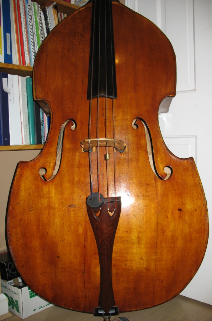

On mine that I mentioned, the page is up now. I am not sure of the age exactly and also not sure if the Scroll is a later period as it doesn't match to my eye. ![]() ![]() ![]() Here's the Scroll that I'm not so sure about; ![]() and with an interesting 'Lyra' Button as well; ![]() |

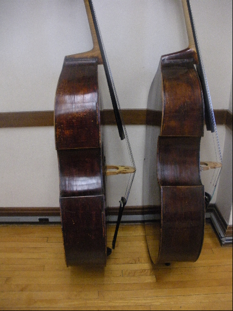

OK...let's see if this works. When the basses a placed back to back, the difference in model size is clear. There are subtle differences in the varnish/color. To my eye, the ffs are the same or very similar. Even the bracing on the inside is the same (although the bass on the right the original two lower braces have been replaced with a single brace, there are marks where they 'used' to be). AND there is evidence in both basses that the cross braces have been 'let into' the inside linings.

I was curious about your Mittenwald bass. It has a bevel near the top of the back. Most Mittenwalds have a slopped back towards the neck block. How about the inside braces, are they 'let into' the linings? How many braces are in the back. Nice bass. Do have ideas about a possible maker? (Seitz, Venner, N & H? etc.) I'll post a photo of the scrolls of the pair of Mittenwalds. They do not have the same type of gears nor are the scrolls similar in shape or size. |
#45
I doubt the Scroll is as old as the Bass and is a northern Scroll as well to me. Maybe Markneukirchen 100-120 years old. I have seen others like it and the gears a well. The Back shows signs of a Neck/Heel break in the past. This Scroll as well was once pinned through the button and then maybe a new neck grafted after that failed. The Bass sounds great and I can only assume it was heavily used because of its sound. It is one of the best German Basses I have ever played. On the Linings, the blocks at the bottom bout are cut and the lining butted up against the notch, the same on both sides. The middle bout linings are flush, not inlaid as are the upper linings into the upper blocks. Only the lower back side bottom block are notched. One side it goes in and one was trimmed back. There is a center crossbar 3" in width, a lower crossbar shaped like a bassbar, a middle crossbar shaped like a bassbar and an upper one covering the angle-break that is a flatter bar but rounded softly about 2" wide. There are many repairs inside the back as you can see the numerous splits in the Birdseye. I am just now dropping some glue on a lower crack inside that has no visible repair to it. When the bass goes this Summer to Jeff Bollbach, I will have him put some linen over it and go over the whole bass. It looks like the repairs are several years old and may need a touch of fresh glue in a few spots. I don't think the bass needs to come apart at this time. Jeff, if you hadn't asked me to look inside at the back construction I would have not seen that faint un-repaired crack. Thanks.. ![]() The shoulders of this Bass slope a bit more than some other Mittenwalds but then again, there were several shops and makers in the 19th century making basses and/or producing parts for them. The red varnish over the yellow under it is also common with Mittenwald basses. Quote:

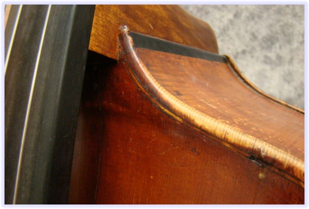

I've recently come across this instrument. The string length is very long (over 44 - notice the false nut.) The neck joint sits on top of the body. Inside there are five braces, one in the middle (for the sound post) about 3" or so, two for the upper and two for the lower. All the braces are let into the linings. The front is perfled and the back is not. Black strip running down the back. There is an extra turn in the vollute (sp?) Any thoughts? Perhaps this may be a N & H or Mittenwald bass? |

I often wonder with the old talk of cottage industry along with big factories and some bass specialists if there was much subcontracting going on between Firms or actual makers. The Export business was booming from what I have read so the possibility exists I think. Must be a monster sound. Can you post all of the measurements maybe? My Mittenwalder Bass is starting to puzzle me though. It has the angle break rather then the gentle sloped back, no center back strip, only 4 cross bars in total with one in the center/post position and one across the angle break, the lower bout wide like a full sized bass (28"), the middle bout (14.75") and upper bout (21") like a full 3/4 with a string length of a full 3/4 bass (41.75"). Most of these Mittenwald basses I have seen were uniform in sizes, widths and string lengths, not a hybrid like this one. Mainly I think it's the 28" bottom that puzzles me for its general size. That to me is more like the Northern English Basses of the Tarr school. Perhaps they offered an 'English model' back then in the mid 19th century to compete with the English! Possibly? According to at least two sources, Mittenwald was making some basses for Tarr, possibly Neuner. Although my Bass is not English, it is more of an English model in design than it is the typical Mittenwald style but sounds like an old German Bass. The Top arch looks Stainerish but the shoulder slope seems almost like a solo bass as compared so some of the other monster Mittenwalders I have seen. Maybe Solo/Orchestra was the model they had in mind. What do you think? |

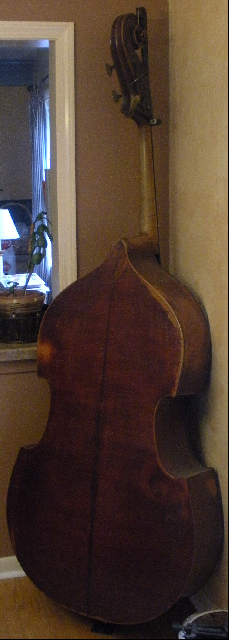

Here's yet another bass that may fit into the 'big bass' category. The shape is typical, the golden color reminds me of a Seitz bass I posted earlier (on page 1 of this thread). The machines on this bass are just like the one's on my big bass (and if you look close on the photo of the Seitz bass, it has the same machines as well).
I do agree that your Mittenwald bass is reminiscent of Tarr bass. In terms of my comment about your bass when compared to Yankee basses, I was only referring to the ratio between large lower bouts and the relatively smaller upper bouts I've seen on some Prescott basses. |

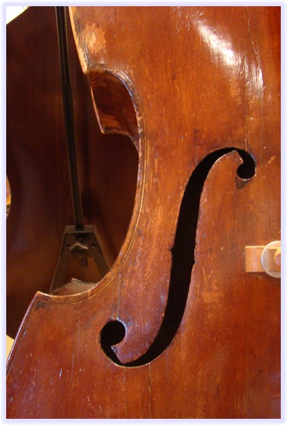

Ken, these brass plates are very unique (and original to the bass...so useful in identification)...and seeing as Jeff has two pictured, I have one, you have seen one...it's a shame we can't put a finger on who made these!
