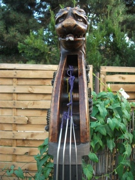

Coming soon, a father Lion 'Mufasa' (old Bohemian) to sit beside young 'Simba' (Bollbach).

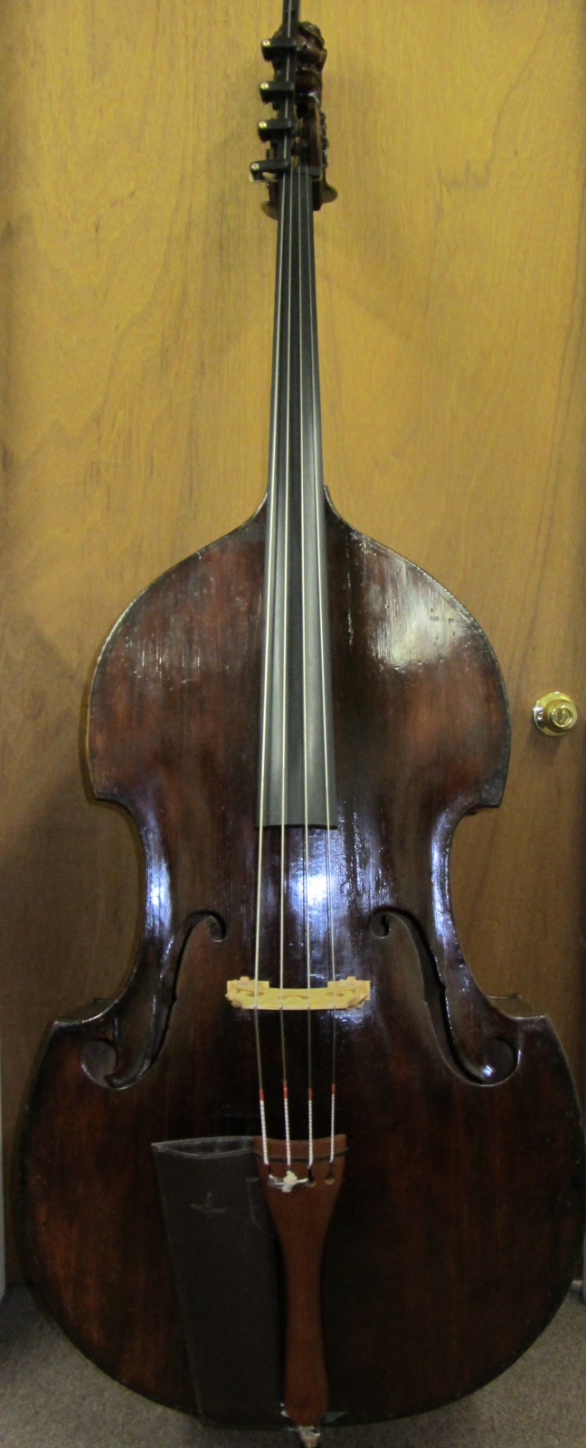

Thumbs up Mufasa is home.. New home..
I just packed the bass after setting it up. It usually takes me within an hour to put the post in and bridge on that were previously fit. The Post went in fine but, that bridge was up in the sky. 16mm on the E and 11mm on the G with some solid core steel strings. The E measured. .116". As thick as my Jargar E/C but that's a relatively soft feeling string. These things were so stiff, I could barely coil them as I was taking them off.
So, the bridge was a Belgium style with that tall arch and the top was cut down close to the heart. It was only 6 5/8" high in the center so I didn't have any room to cut from the top so, I drilled it for adjusters and cut out 1/2" of wood from the tall legs and set it up with some old old adjuster wheels I had lying around.
The bass needs a new bridge, endpin unit (maybe) and tailwire as well as a fingerboard dressing. The tailpiece is this creamy brown colored wood and it's quite heavy. I think it is European boxwood. It is heavier than maple and weighs an ounce more than a similar size maple TP I have on the shelf so I think I'll keep it on the bass.
I will try to get pics up if I can by tomorrow. If not, later in the week. I got so involved mentally working on this bass that a few minutes after 10pm I realized that I had missed an Orchestra Board meeting that I wanted to attend. Well, it was worth it. The bass is covered and in my rack. It has that black/grey kevlar type rope tailwire. It kept slipping so I took all the stings off before it ran out of rope to pop and then tied it all in a knot in front of the other knot and I think it will hold. If not, keeping the bass packed up might prevent more damage if it does go in the night and stay contained in its case.

Passione G,D,A, and Stark E Passione.
The E is louder than the A. The bass has a powerful deep sound. The upper register as well as the low register is smooth and silky. Close your eyes and you will swear it's a 200 year old Italian. Someone yesterday told me the F-holes remind him of Testore but I highly doubt this bass is anything Italian.
The FFs are not evenly cut from one to another. Not the nicks, the holes, the curve, the placement or the fluting at the bottom. This is a one-off hand made original. The shoulders are not symmetrical either being that the treble shoulder is slightly more curved for playing then the other side. The C bouts are not even as well. Like my Gilkes was, the upper corners are opened up for bow clearance with the lowers being squared across.
This bass was made for comfort. It was about a 43" string length before but after restoration, it's just under 42".
Speaking today with a former owner who spoke with the former owner HE got it from was told that HE, the 90+ year old German player bought it from another old player in the 1950's and that HE was told that the Shoulders were Cut down from even a larger bass. Just how and where the bass was cut I can't say and don't know but this was bigger when it was made.
So, I have some basic knowledge of the past 3 owners spanning a century or so. The bass was probably 100 years or so old before it was cut. That being said, the last previous owner who is also a dealer and player thinks the bass is much older than it's shape and model leads us to speculate at first look.

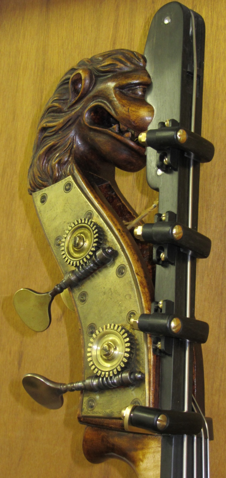

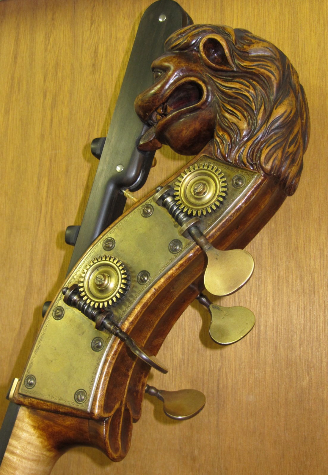

The Gears are something for discussion. First off, the brass shafts have a wooden sleeve over them the entire length thru both cheeks (I don't have a close-up of it at the moment, sorry.) These are very old, the wood, almost as if they were there before the brass gears were put on the bass. Old basses before brass or iron gears had large cello-like pegs. I think these could be from those pegs, possibly for a few reasons. One mainly, there are no other screw holes in the scroll cheeks from other than these gears that I was able to see when I was shown pictures during the restoration.
Now, look closely at he gear-worm brackets that attach them to the plates. On one side they are rounded and the other, more square like. Also, the side with the square type are each different. The screw mounting in the center of the gears are just slightly different on each side as well. Also, each handle shaft is also a bit different in one way or another. One of the teeth on the upper bass gear (E on top) was repaired as it was broken off. I requested they fuse a piece of brass in and re-cut the teeth. It's working fine now. Have a look;

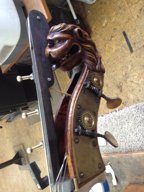

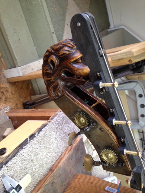

Thumbs up Mufasa gets a Face Lift..
Note: C-Extension in progress.
There were no holes drilled in the Lion at all. His 12 teeth and long tongue remain intact and unaltered. This is the first Extension like this I've had with a double wheel where the string feeds back under the Ebony which holds the Extension in place by pressure and a single steel connecting Pin set into the top of the Fingerboard. The Pin is used in all the Extensions that Arnold has made for me. Now, I can use this in Orchestra and not switch basses because of the lower notes written on some pieces.
