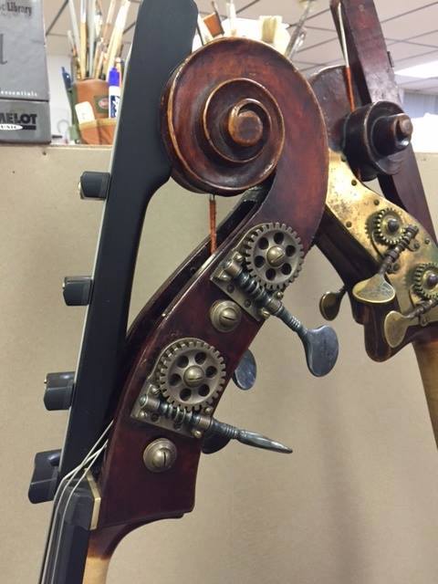

Well ... I'll stick my neck out and say no, I don't see enough similarities between the photo pairs to think the basses are from the same model or form or maker's hand. Yes there are some similarities but enough differences as well to cancel them out, in my mind.
That long head is interesting; its length and line doesn't seem to match the body it is attached to! (and no I realize it's not attached to the cornerless below it!)
Both basses above, head and body are made by or attributed to members of the Marconcini family. I have pictures on file of another bass by a Marconcini as well, Giuseppe supposedly. Mainly they worked in Ferrara but one of them, Luigi, worked first in Bologna and then in Ferrara. I see only similarities myself but Luigi built lutes and Viols besides Violins and Basses. I was just on a hunt when I found these when looking for makers in Bologna that made Guitars and Basses as that's what my bass looks like, a combo of the two.
The Bass I examined that was stamped 'Lod Parisini' on the tuner plate is a puzzle as well. Was he the bass maker, the gear maker, an owner of the bass like with the name 'Dragonetti' we have seen on some plates? So, without confirmation on even Parisini being the maker of that bass, I am still looking. Bologna is what some thinks it resembles in style and the list of possible makers for style and period is short.

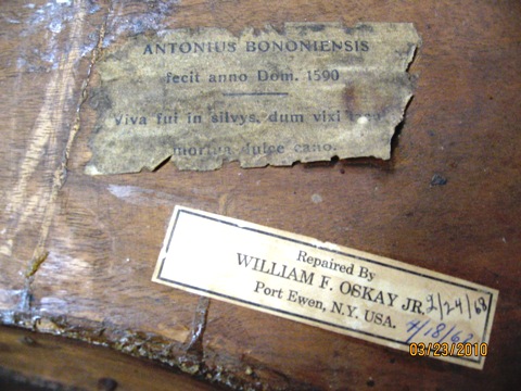

Cool Labels..
Here are the labels in the Bass. One is from a repairman and one, the old 16th century Lute maker Antonius Bononiensis which I believe is false for this bass and period;

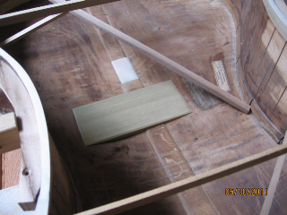

Cool Added center brace..

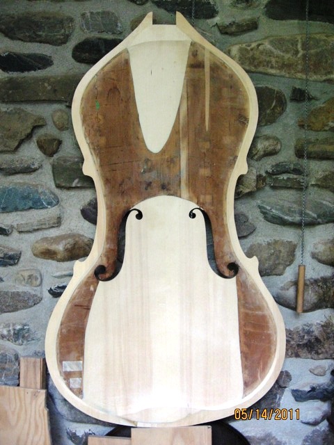

Here is a picture of the Center Brace during the restoration. You can also see some scored lines in the Rib and Lining. This is how the Bass was made, scored and then bent with the Linings in place. Also, here is a side shot of the Bass showing how nicely the Top pressing came out along with the Varnish touch up and polishing. The Bass sounds beautiful by the way and is a joy to play on.

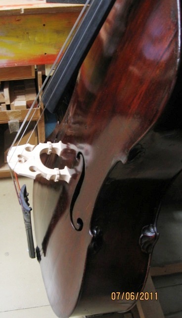

Nice pics there again. Interesting that the linings were bent with the ribs. Sounds like hard work!
Any clues on how the scallops were carved? I'm guessing in situ, but I can't see close enough to tell. Since they are so unique on this bass, suggest you include a closeup of one of them as an extra photo!
I note you have put a very wide bridge on this bass, it looks as if it overlaps the FFs by at least half an inch, or more, on either side. In the past, you have been adamant that this is a bad thing and causes belly to sink at the ffs. Any comment on the situation here?

On the Pics, you can click and blow them up a bit to see the Scallops better. I can't tell if they were carved totally after gluing to the Ribs but anything is possible. No two Scalloped blocks are alike within the eight of them. The work is quite nice and easy on the eyes as well.
On the Bridge, the width of Legs of the feet measure exactly the same (just under 130mm) as the width of the upper F's eyes. The tabs of the feet do spread out a bit past that as you have pointed out but nothing in the area of concern. The Bass side bridge Leg is right on top of the strong new Bass-bar. If the Legs themselves were wider than the F's upper eyes, this would be a concern. The Top has a fairly big 2-piece book-matched breast patch covering most of the lower bout and reaching up thru the F-holes as well. Quite impressive 'fitting' work from what I have seen. Have a look below. I guess you have to see a bass like this in person. It is quite loud and deep but does not have quite as much of the depth spread of the larger Storioni, just some extra low boom over it.
The Bass-bar and some other cleats had not been done yet when this was taken. Both the lower and smaller upper breast patches shown here with a complete half-edging as well.

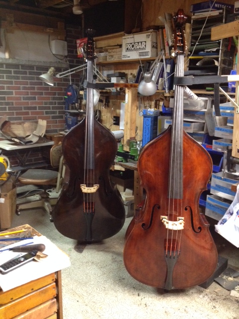

Arrow with Maestro Sciascia and 2 copys..
Here are two pics from the ISB with the great Stefano Sciascia with the Marconcini. Also pictured, 2 of the 3 modified copies I had made in Europe and just recently completed in set-up by Mike Magee (pics from his shop). The first copy is being re-built by Mike and will be ready some time in the near future. The first copy was done from measurements and pictures taken from the website. The other two were commissioned after I evaluated the first bass and made some modifications to slightly increase all of the measurements. As you can see, these have actual violin corners, unlike the original 'scallopini' design.
